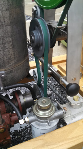

    Here it is working away
    Here's the tensioner, it works just great. The whole thing still shakes but not quite as bad now, not a problem any more I don't think.
    An overall shot, note the new shift lever for transmission, and mounted the oil pressure gauge so it won't flop around any more.
    No video this time, it rained all morning.
    It does need a muffler, or I tested and it needs at least a 2' longer pipe to take the harshness out of the exhaust. Picked up a smalll ford tractor muffler of some sort from Tractor Supply this morning, I'll see/hear how that sounds.
    Also on the to do list is make a tongue for it, almost done with it already.

    Try these picture links.
    https://picasaweb.google.com/m/viewe...03521889914530
    https://picasaweb.google.com/m/viewe...03126652324514
    Took the contraption on the road today for a family gathering, made some tasty mint chocolate chip, picked the mint about midnight last night..
    It works quite well, easy to start, only uses a few spoon fuels of fuel for a batch.
    Bought a muffler to try, not much help so I'll return it. Went back to a 2 foot piece of cardboard tube and a hose clamp, works nicely and sounds great. Anyone have a couple feet of 1.5" stainless tube laying around?
    The knob on the filter housing is a primer pump, feels like a diaphragm type and works well for burping the air out. Housing is off some imported truck, got it from a friend who had it new but unused.

    Found a nice tank, it was even free. Muffler too, as I had it on an old Wisconsin 2cyl.
    Need to make a bracket for the tank and clean it out, nasty old gas/varnish.
    Easy way to clean it is to take it apart which was easy enough to do with a torch and a little compressed air to pop it apart.
    It also had some dents that were easy enough to remove once I got it apart.

    No glass bowl on that one?

    Nope, just a 90* shutoff valve. If I were to use a glass bowl filter the bracket would have to be much taller and unstable with as much as this thing shakes around. It has a much oversized primary fuel filter and probably won't burn but a gallon or two a year so I'm not going to miss the glass bowl filter, although it would look nice.

    Well it looks like you should checked your own stash Either way nice job, how does it sound now with the muffler? That muffler is quite popular out here at the tractor/thresing bees!

    Not the best pictures but here is the new tank and muffler installed.
    I did have the muffler, the tank came from a neighbor, I made the bracket for it.
    Pulled it out of the garage last night and it seems to work just fine, sounds a little quieter but certainly not silent with the new muffler, pretty good I think.
    Only trouble is the exhaust pipe wants to unscrew from the head as the engine shakes, I'm going to try pulling it apart, clean the threads, and use some Loctite. It supposedly lets go at about 400 degrees F but I think the exhaust is running pretty cool, and the head might keep the flange cool enough. Worth a try anyhow.
    Looking for a throttle lever next and it'll be done. Well I'd like to raise the whole thing 1" above the axles so the wheels can fit under the rails to turn more, tighter turning radius. Then sometime I can add the second freezer if I want, shaft is already there to run it.
