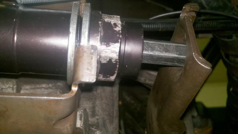

Info that may be of some help, sourcing a pilot bearing for the Ford adapter.
I noticed that 6303 is a common input bearing for alternators.
First noticed this on a Ford 3G I was going to use.
So sourcing one from an alternator repair shop gives another avenue of purchase where it should only be available in the prelubed double sealed version.
