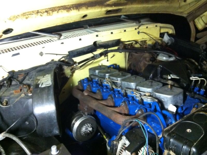

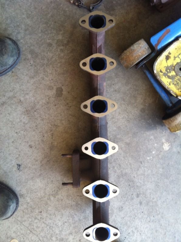

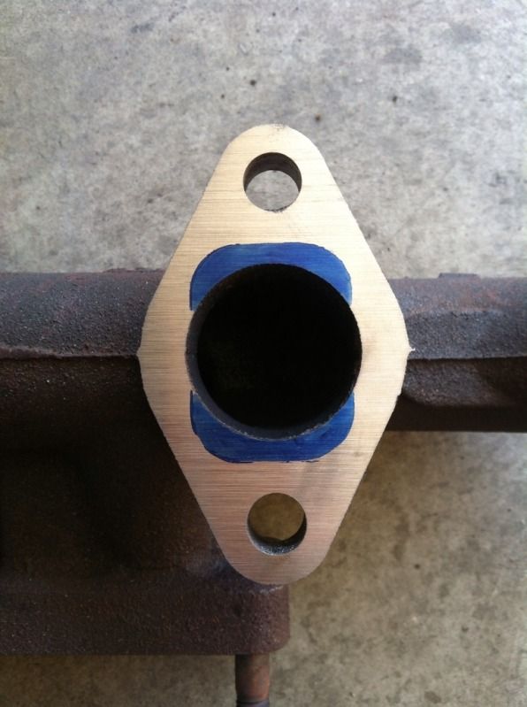

Well i got the Common Rail mani mounted up this weekend. I just took the gasket and marked where i needed to take material off and took my die grinder to it. Everything worked out quite nicely. Here are a few pics. I forgot to take some before i put it on of the porting:

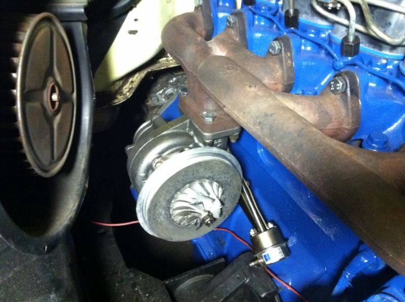

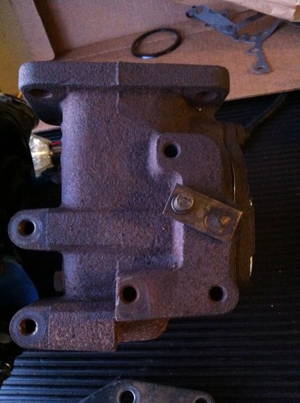

Now i did have some troubles with the wastegate actuator. It is hitting the block. I guess theres a turbo that has it mounted 90* from where mine is, i dont know. Or you can remount it 90*... I dont see how to do this, but maybe you guys know? Here are some pics of how it mounts now:
-Jon
a wh1c off a Ford medium duty cummins will have the wastegate actuator mounted differently. If I remember right it points toward the front of the truck. But the little wastegate tab itself was attached at a different angle too. That's what was on my motor and I sold it and used a Dodge manifold and turbo since it fit better for my application.

Ya, i found an exhaust housing wastegate for it. Goldfarb and Associates is my number one place to buy turbo stuff. I called them up and they have everything i need. They even sell whole core turbos for $150 dollars. Great place to do business.

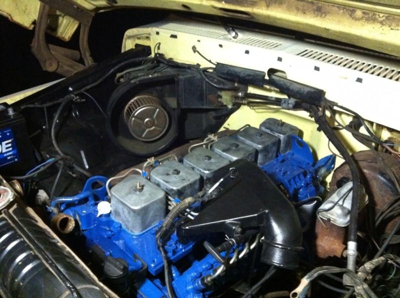

Hey guys, its been a little while since my last update.
I got my new turbo housing with the 90* mounted wastegate actuator and it fits perfect! As of right now about the only things left to do on the truck is finish up the wiring, weld up the piping for the downpipe, intercooler, and lower coolant house, modify the sender for the return line and a larger feed line, and run a couple fuel lines. Im hoping to get most of the wiring finished up tomorrow so this thing will be ready to start as soon as we finish some welding. I have all the piping, just need to get the tig ready to go. I also need to remember to install my GSK and fuel plate, but that shouldnt take to long. Im thinking the first start up will be in about 2.5-3 weeks. Maybe sooner, but we will see. Here are a few pics of the progress. You will have to excuse it being dirty, i will clean all the dust off once the wiring and plumbing is done.
Heres a picture of how the new wastegate actuator works. The comp housing is off because i was removing the silencer ring and cleaning the housing out.

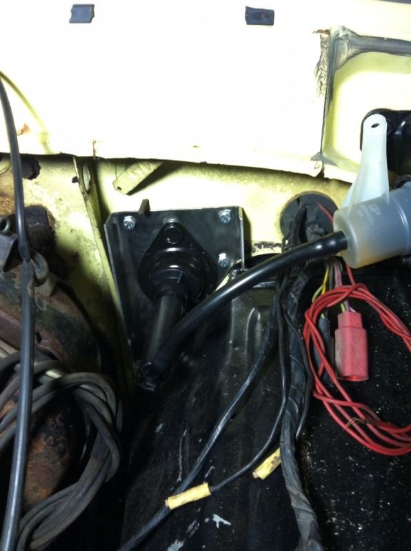

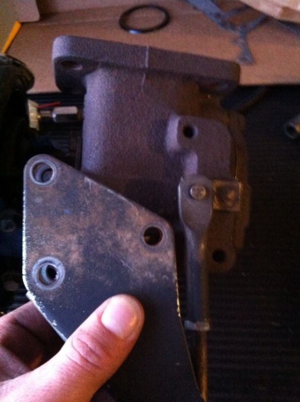

Heres a picture of the mount for the clutch slave(?) cylinder. It is a 1/8" piece of stainless steel with two 90* bends for stiffeners.
