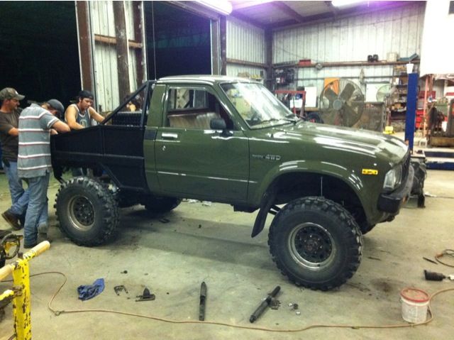

Here is a picture of my buddy with the truck the way I bought it

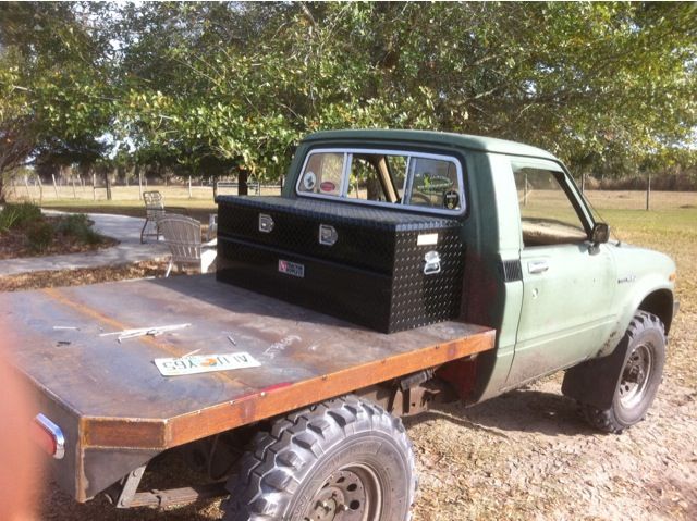

First thing I did was buy some tires for it, then the Nissan bed had to go

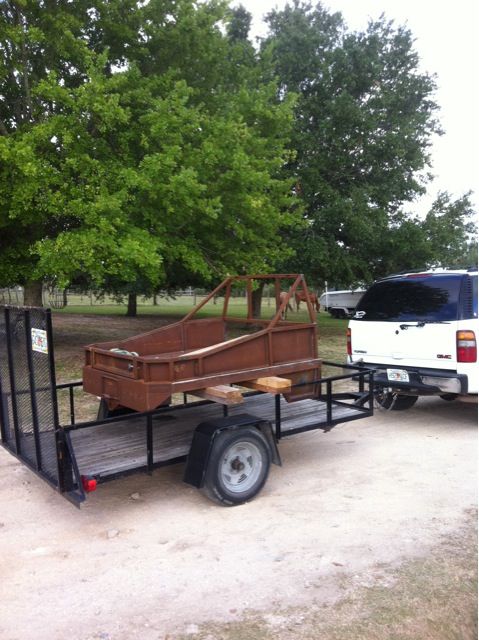

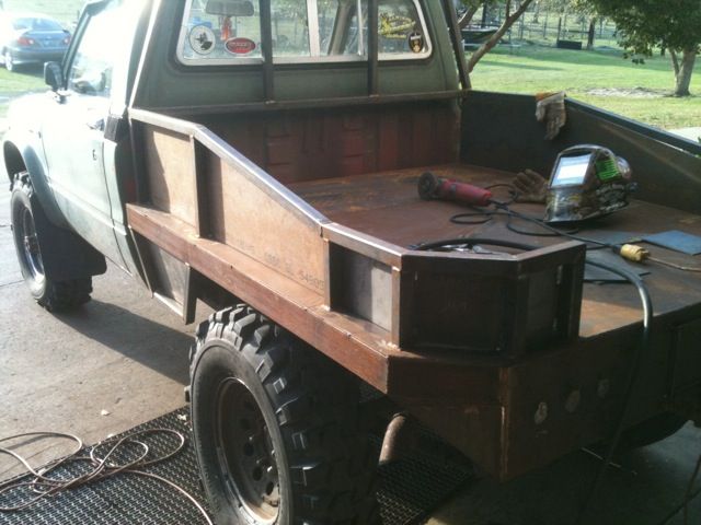

Project flat bed is underway

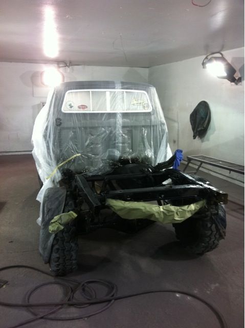

Off to sand blast and powder coat

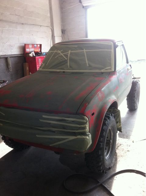

While the bed was gone, I figured now would be a good time for some fresh paint

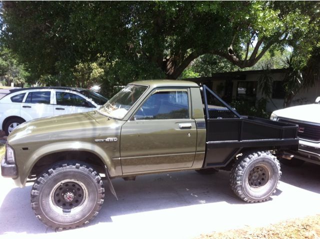

Fresh paint and freshly powder coated bed

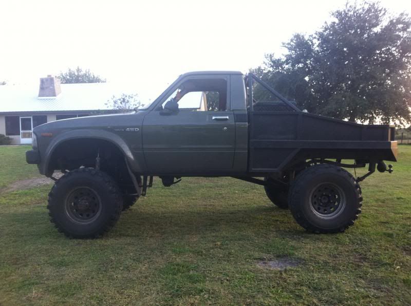

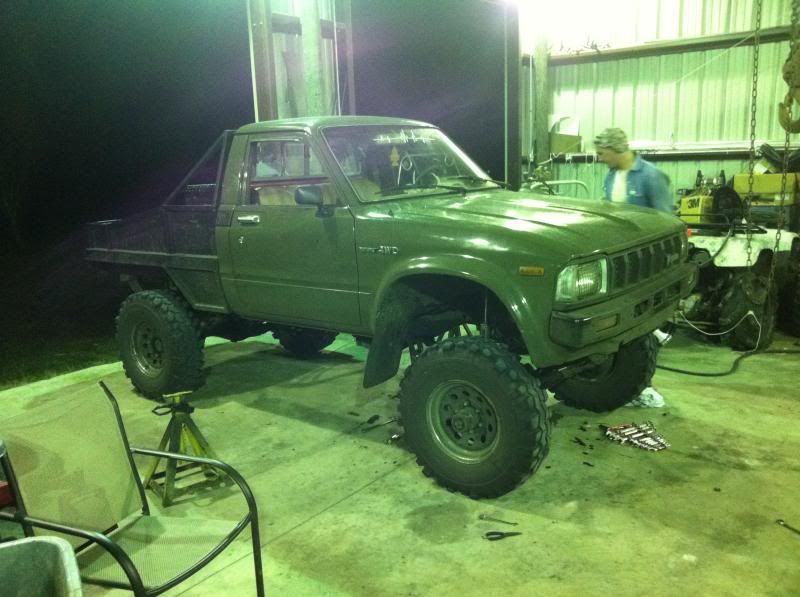

When loaded, the bed would rub the tires some times, so I installed a 4" lift
Then we built some drop shackles for the front springs to give it the more desired stance I was looking for

I didnt want to put a body lift on this truck, but I had to, due to the height of the 4bt.
Motor fits. Taking measurements for motor mounts

Are those body mounts permanent or temporary? I would never recommend running a body lift that high.
15 Posts
Discussion Starter #5
Unfortunately, they're permanent. I didn't want to put a body lift on it at all, but due to the engine being so tall, I had to for it to fit in the engine bay.
784 Posts
Just judging by your last pic it looks as if you could shorten that lift some, mabe even half?
15 Posts
Discussion Starter #7
From the measurements, it needed about 3", so I built it 4" to play it safe. Once I get the motor in, mounted, and the hood back on, I'll be able to see the smallest I can go, and build new body mounts.
