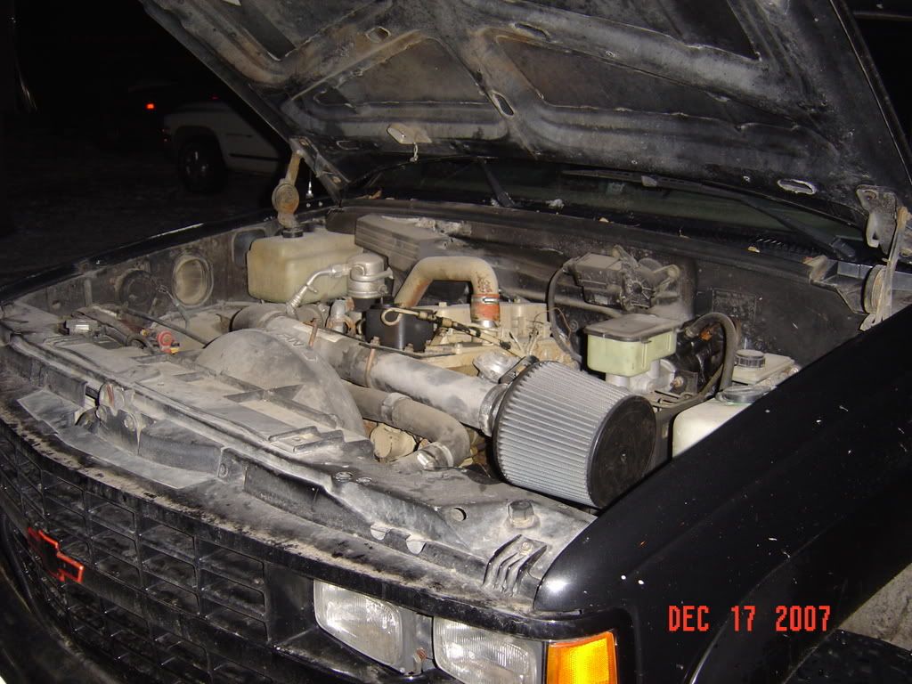

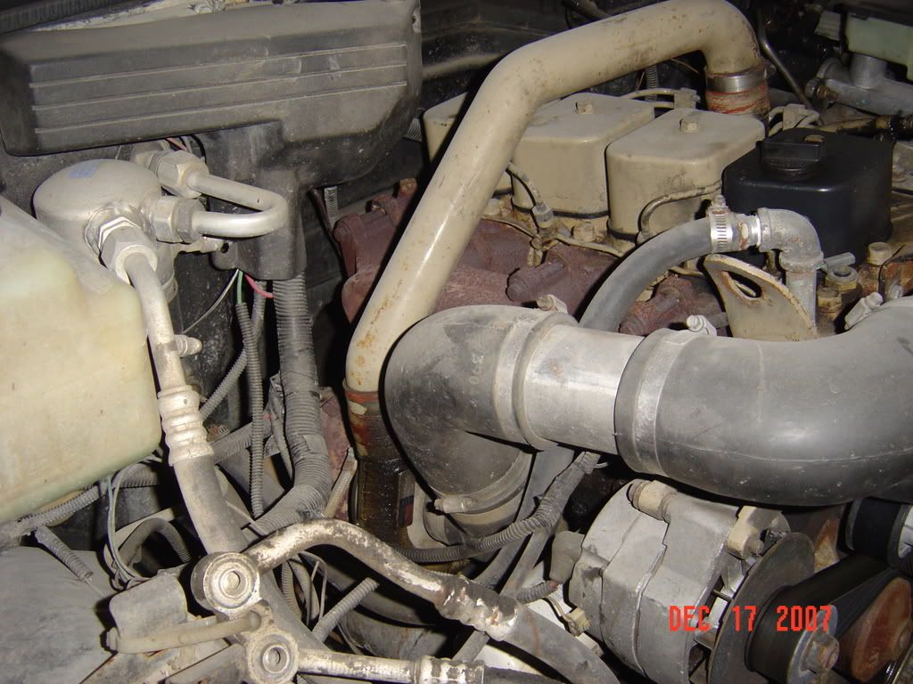

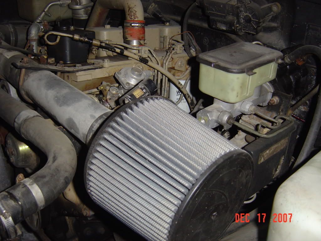

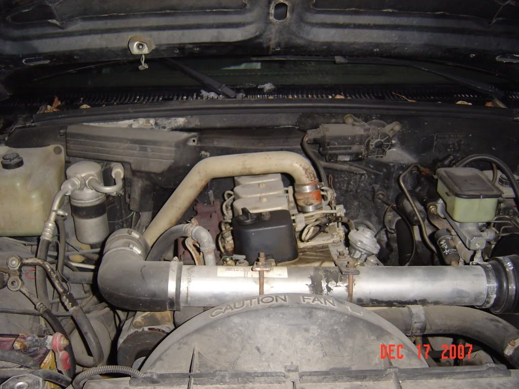

Dieselfidder had ask about some pics of the Chevy, and I kept forgetting to snap some, so I went out tonight and took a few. Don't pay attention to the dirt, it is a daily driver, and it is too cold and nasty here to wash anything.-Nicholas

It is the little aluminum 5-speed, I honestly have never checked the gear ratio. I am going to say it is probably like a 3.08 or so ratio. With the gears, and the 33" tires, I have to be doing 60 MPH to shift into 5th gear, or it will lug the engine. I have only checked the mileage a handful of times, and it is usually in the mid 20's, with the highest being 27.
34 Posts
Cool man!! So overall are you happy with the swap? I am probably 2 weeks away from fireing her up. If your getting mid twentys and the highest being 27 mph ill be happy to get that too. You probably have 3.73's, that what i have with the NV3500. Thanks for the pics!!

did you convert to hydroboost, or was it originally hydroboost? Is that the original master cylinder? Is the booster from the P-van? Thanks
I converted it to hydraboost. It is the master cylinder from the same year truck that I ordered the hydraboost from, which was '96 GMC 3500 4x4 Dually.-Nicholas
