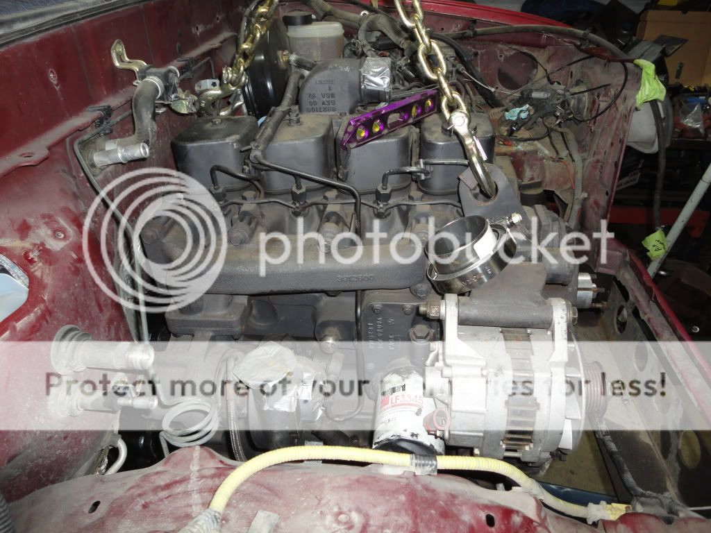

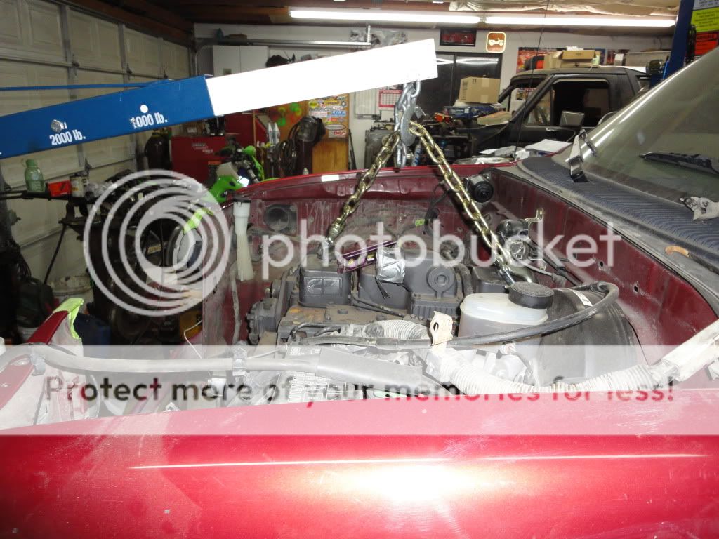

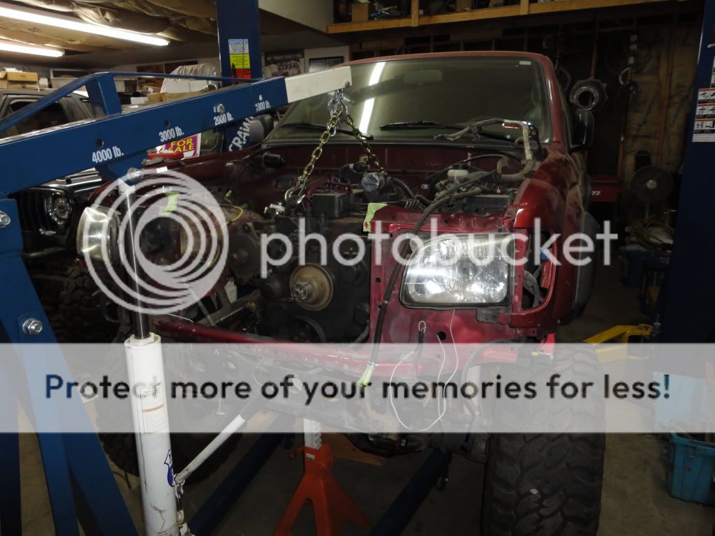

Hey everyone, I’m trying to get some help with some ideas and best mods. I’m currently on my third deployed to Iraq and I’m having Bent Metal Customs in Washington swap my engine over to the 4BTA. I’m hoping when I head home my truck will be finished. Over the next month and a half I will be updating this thread with the progress Bent Metal Customs makes.

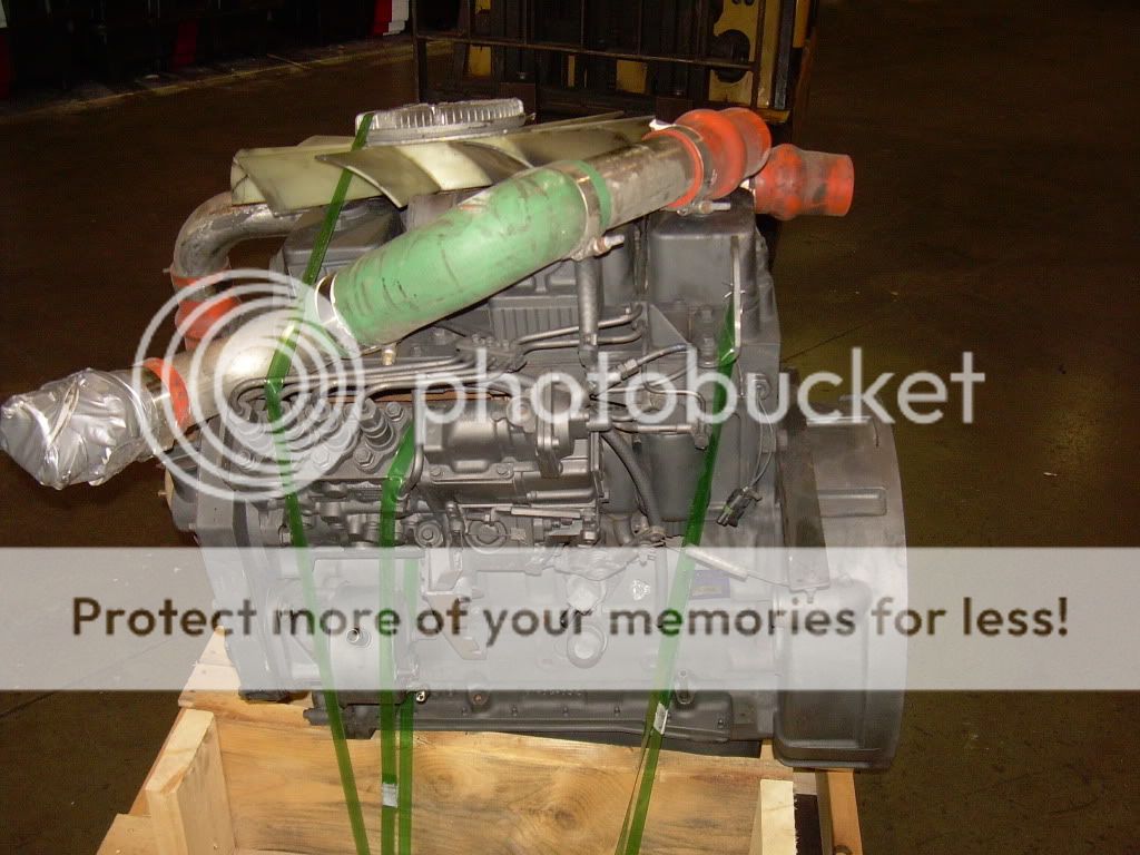

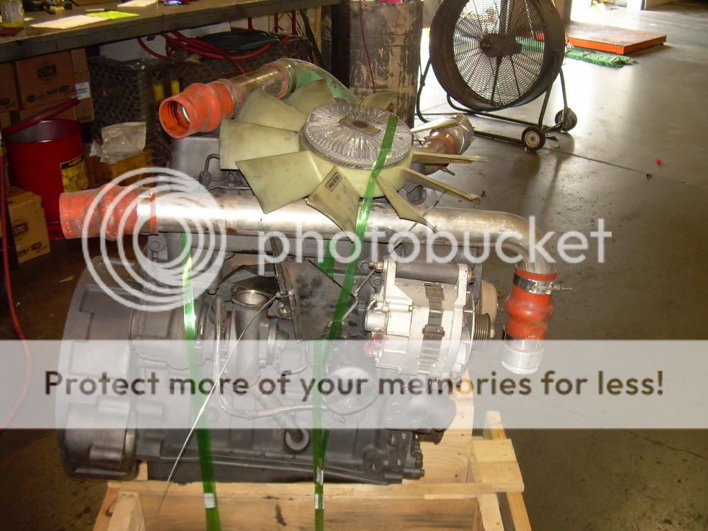

The engine I bought is a 2005 4BTA 130HP CPL 1839, I’m planning on using a Dodge Getrag 360 I bought off Ebay with a Ford NP205.
My plan is to get feedback from you guys on the site for ideas on best gauges, axle ratio, fan setups, vacuum for power steering, air conditioning, governor spring, top mount intercooler heater hoses. Ect

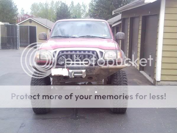

The truck is going to be my daily driver, I’m using the Toyota Tacoma rear end with E-locker, and I had a diamond axle put under the front using a FJ80 high pinion dif. I’m running 4.88s now, 3.54 would be really hard to find for my axles. I have about 7” of lift and running 35” tires

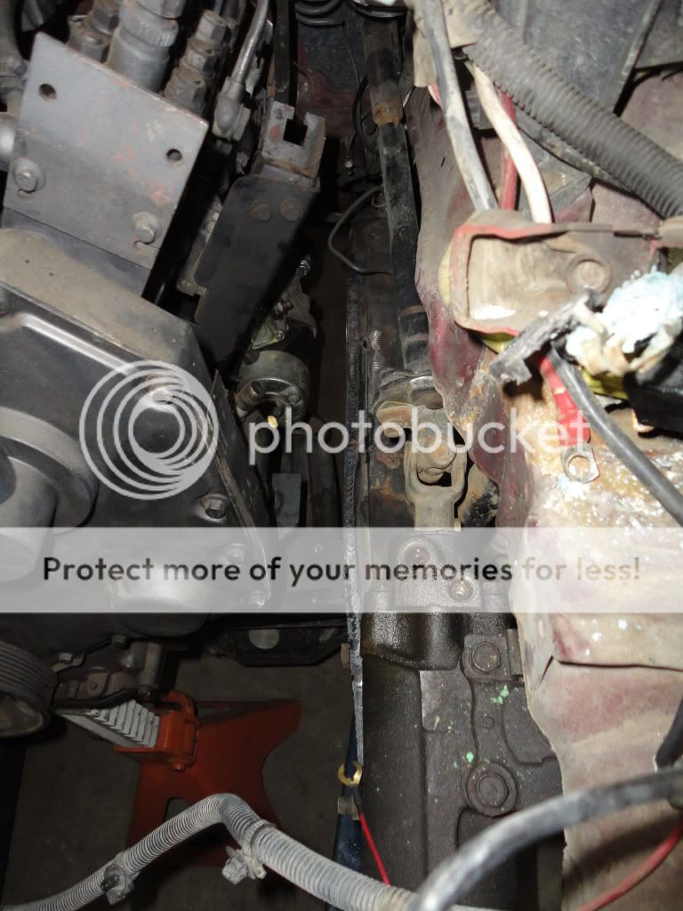

Once the 5VZ-FE is out im planning on plating the from inner frame rails and doing the same where the new transmission mounts are gona be. This should help with the torque, preventing my frame from twisting.
