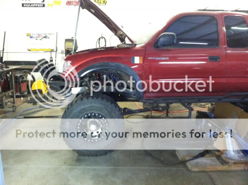

Hey everyone, I’m trying to get some help with some ideas and best mods. I’m currently on my third deployed to Iraq and I’m having Bent Metal Customs in Washington swap my engine over to the 4BTA. I’m hoping when I head home my truck will be finished. Over the next month and a half I will be updating this thread with the progress Bent Metal Customs makes.
The engine I bought is a 2005 4BTA 130HP CPL 1839, I’m planning on using a Dodge Getrag 360 I bought off Ebay with a Ford NP205.
My plan is to get feedback from you guys on the site for ideas on best gauges, axle ratio, fan setups, vacuum for power steering, air conditioning, governor spring, top mount intercooler heater hoses. Ect

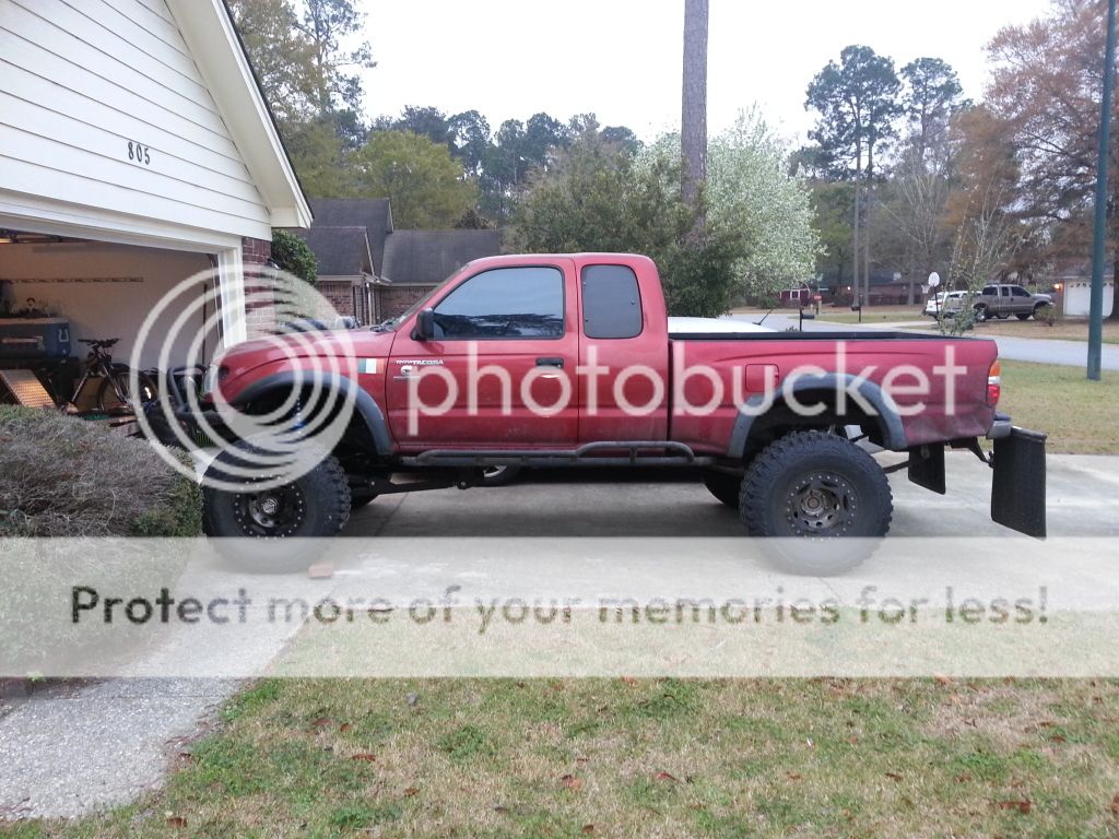

Finely got to lower the truck, new shocks are 10" instead of 14". I also removed the rear blocks I was using. Spring rate is 550lbs on top and 600lbs on bottom. What a world of difference from stability and getting in and out!
I didn't take a picture with the rear blocks out but you can see the angle of the rear vs front.
#293 ·
Looks like you've suffered a bit of body damage at the back of the cab and front of the bed. Too tall might look cool but generally makes for lousy handling and need for a step ladder to get in. I sometimes wonder how guys get in some of the full sized trucks you see on the road. Is the engine performing better since the rebuild?

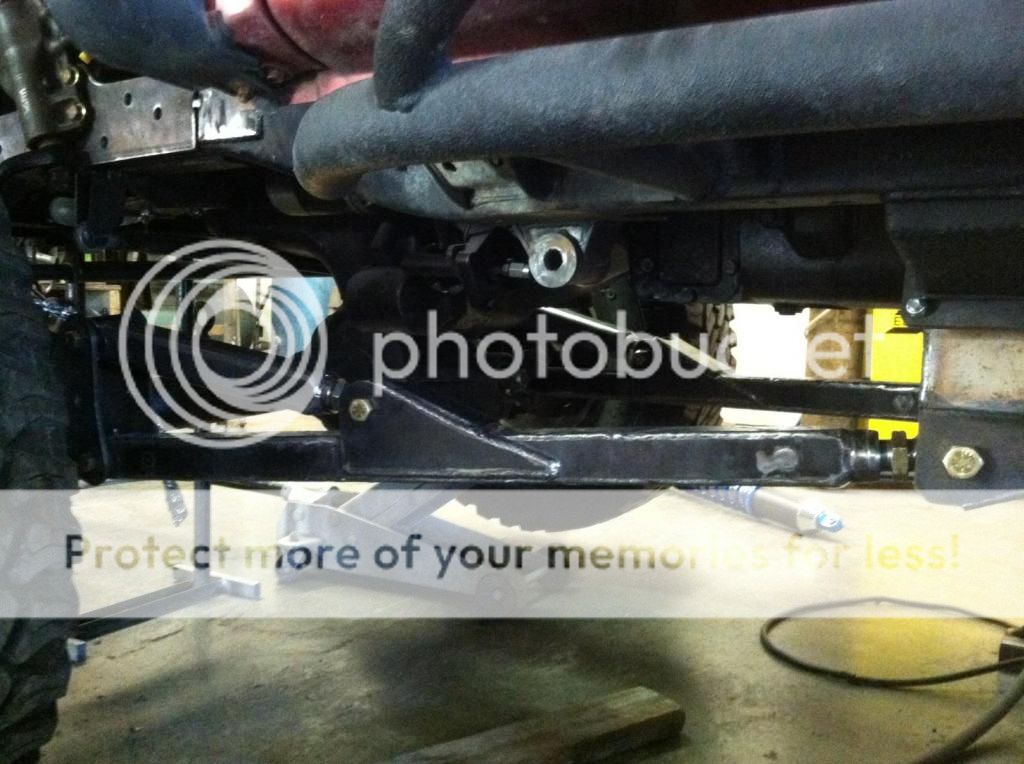

I'm thinking of adding a radius arm to the back axle, mounted near the pumpkin on the passenger side. I'm hoping it'll work better then a traction bar and be able to fully flex with my leaf springs. When I had the blocks in the back I had real bad axle wrap, it probably isn't as bad now but I want to prevent it completely.

There are numerous companies that offer traction bars or anti-wrap bars in the hardcore offroad market. You can often buy just the ends or a complete DIY kit. Or you can just buy a heim joint for the frame mount and 3 shackle bushing kits for the bar's ends. I'm likely going to go with RuffStuff's parts to make mine. I'm running super soft rear springs so wrap will be a major issue without one.

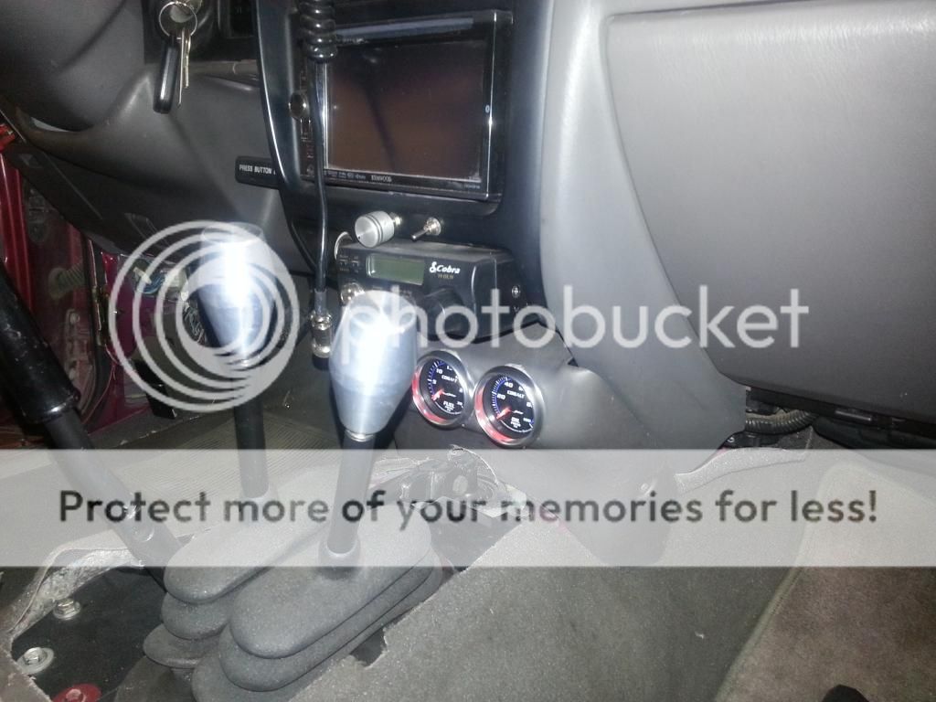

#301 ·
#303 ·

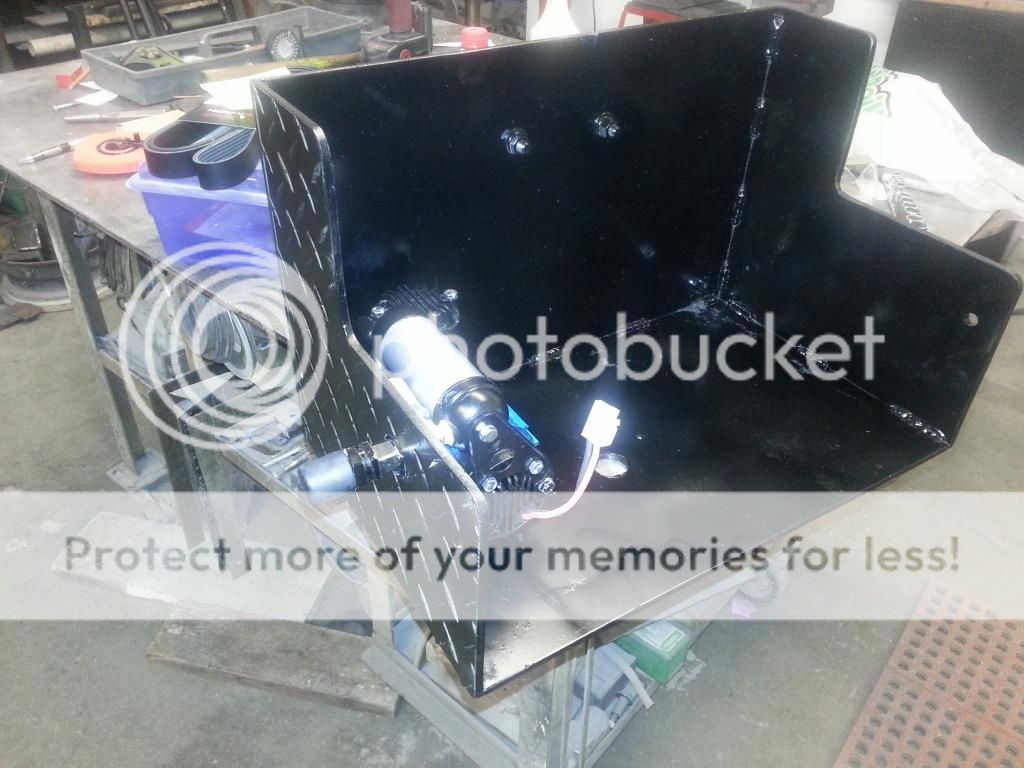

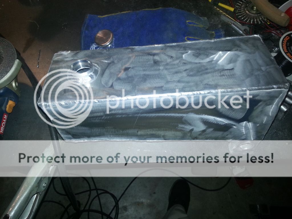

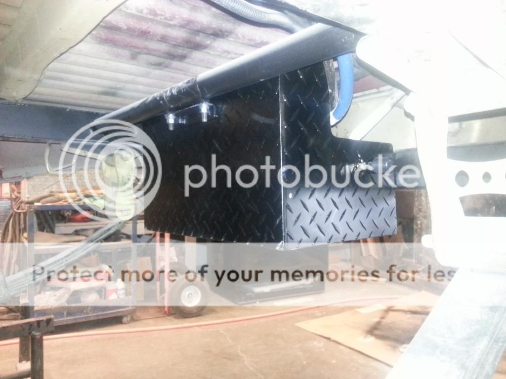

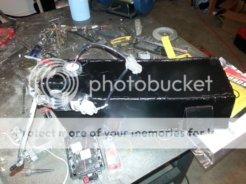

Right now I'm slowly working on a washer fluid tank, with the axle pushed forward I don't have enough room for the factory one. I have a lot of other things I need to work on, just haven't had a lot of time.
#305 ·

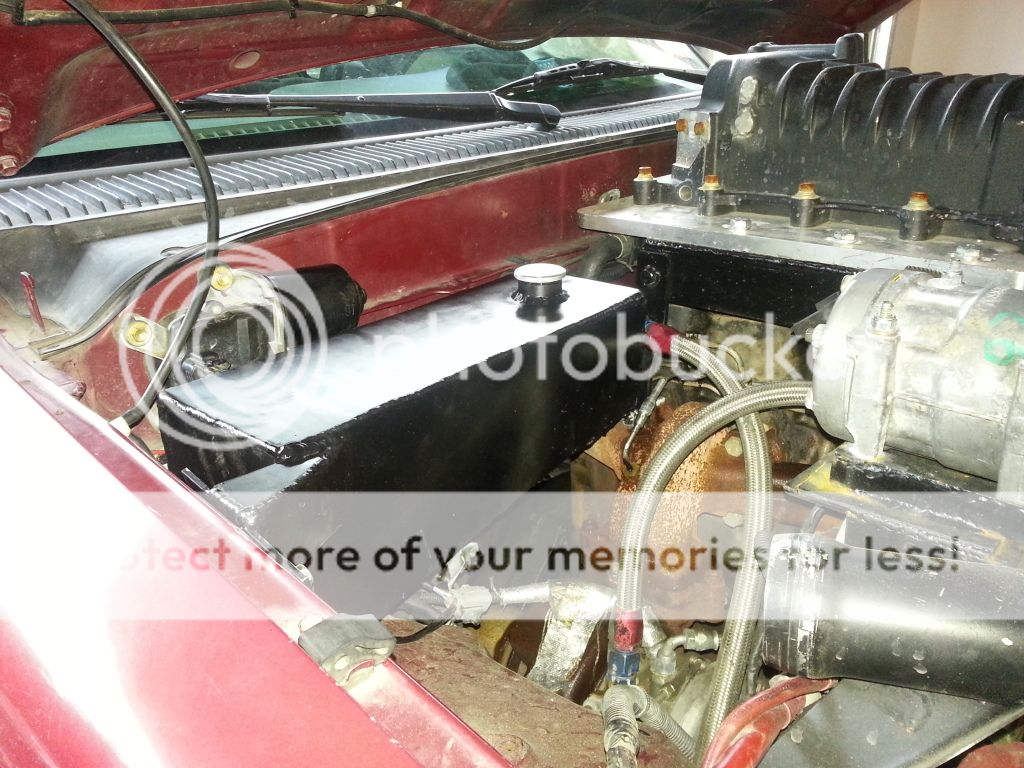

Thanks, this has been a long process making this truck work.... there's been a few times I wanted to torch it and walk away lol

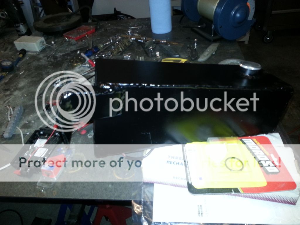

Well today was a good day! I finely finished my washer reservoir! After a year driving around without being able to wash my windows, its such a relief to do it once again :beer:
Came out pretty well, it holds a little over 1.5 gallons, bolts right up like its meant to be there, and uses all the factory electronics.

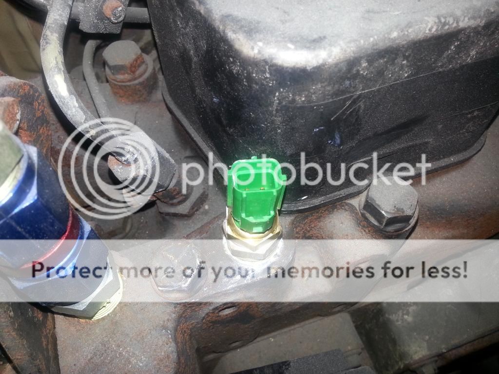

Crossed my mind, but my EGTs are really low, I cruse around 30-45MPH between 5-650F, 60-75MPH around 800F and my exhaust stays pretty clean unless I floor it from what I can tell. However I picked up a weld in NPT bung just incase for latter on.
