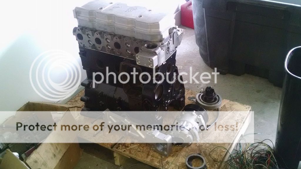

Here's a picture of the powder coated block. Once I get the intake milled on the head its getting painted as well.

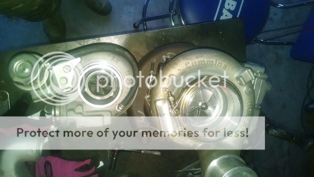

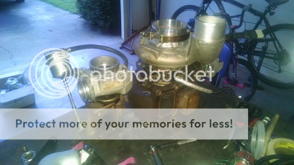

Here's a side by side of the HE221W and HE300VG. Nuts how much bigger the HE300VG is in comparison.
Also drilled out the waste gate port on the HE221W, I wanted to ensure I had as much flow as possible.
#353 ·
You get the head sealed nice and tight?
-vr4oaks
#354 ·
lol no, cant tell there's no crank in the block? I put the head on the block to keep it out of the way and put a gasket under there to keep it from scratching. Its a slow progress, right now im look at what I need to get the compounds setup and looking for a machine shop that can do the work on the block. I want to machine out the cam bores so I can run 5 bearing.

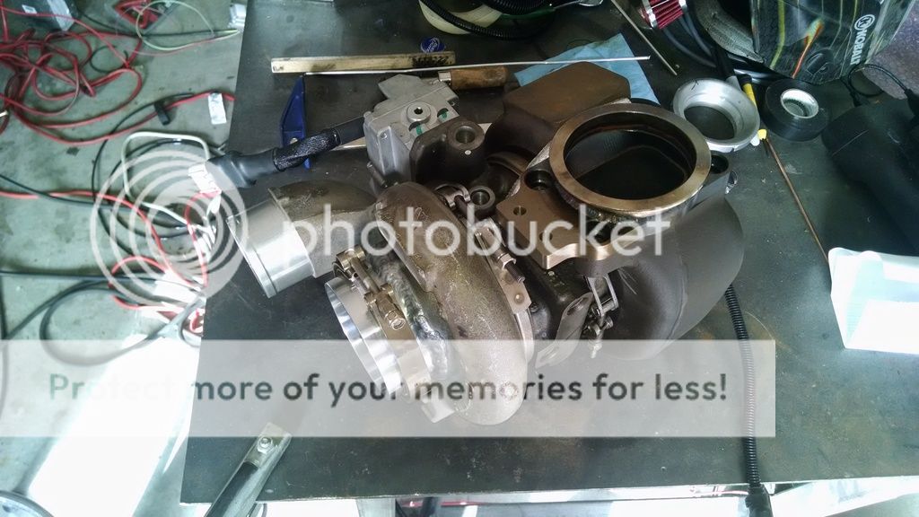

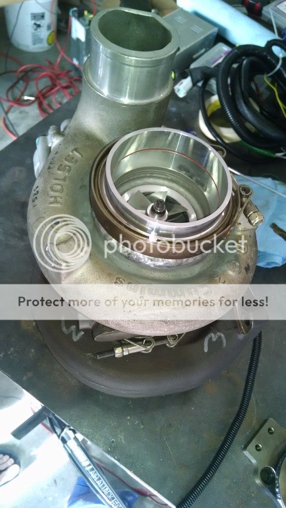

The intake from what I've been told wont clear the P-pump unless I cut a portion or machine it completely off. So I think a runner intake would be my best bet. I'm thinking of welding the waste gate shut and see if SteedSpeed will make me a T25 manifold with a 60mm waste gate. I have 60mm Turbo Smart sitting in my garage I was planning on using for a supercharger bypass valve, figure I should make use of it. I'm a little worried the 6cm housing and tiny exhaust manifold are going to become a restriction in lighting the HE300VG.
