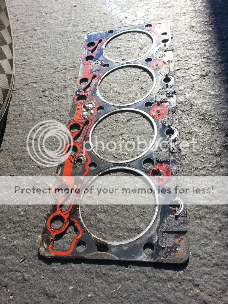

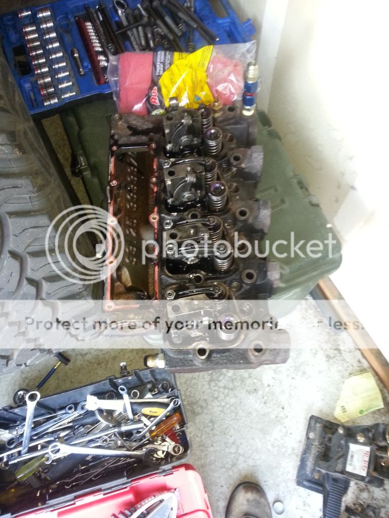

Pulled the head off, heres some pics of the inside

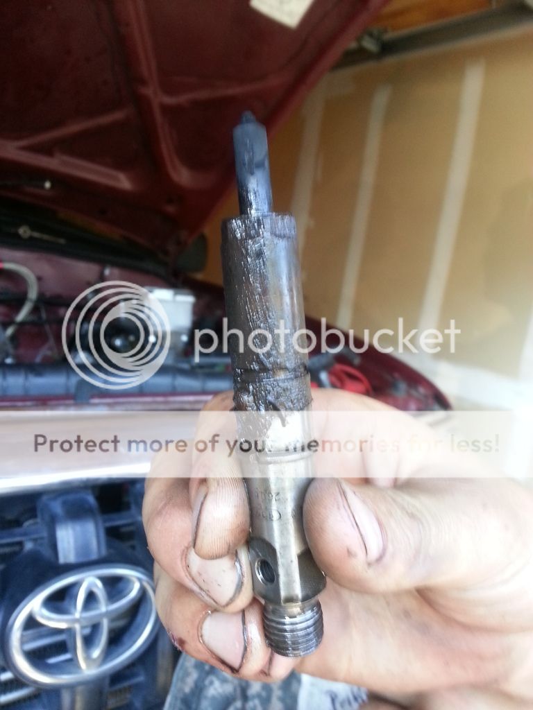

New injectors are pretty fouled up, this one was in the first cylinder. the others didn't look like this one, the others just had carbon build up.
Gasket came right off, some parts of it seemed like it was falling apart
Pistons looked good just dirty, you can still see the honing in the walls. Makes me wonder how many miles is on this engine.

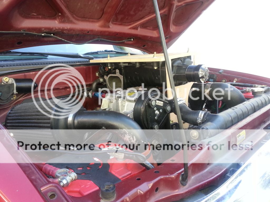

Slowly making progress with my M122 supercharger, the supercharger is going to be bolted to 1/2" aluminum plate, then the brackets for the engine are going to be made out of 1/4" steel with slots so i can move the charger back and fourth to a line to the pulley.

might not look all that cool but its still going to be pretty awesome. the charger is going to be upside down so all your going to see in the hood is a plate and the charge pipping coming out of it.
