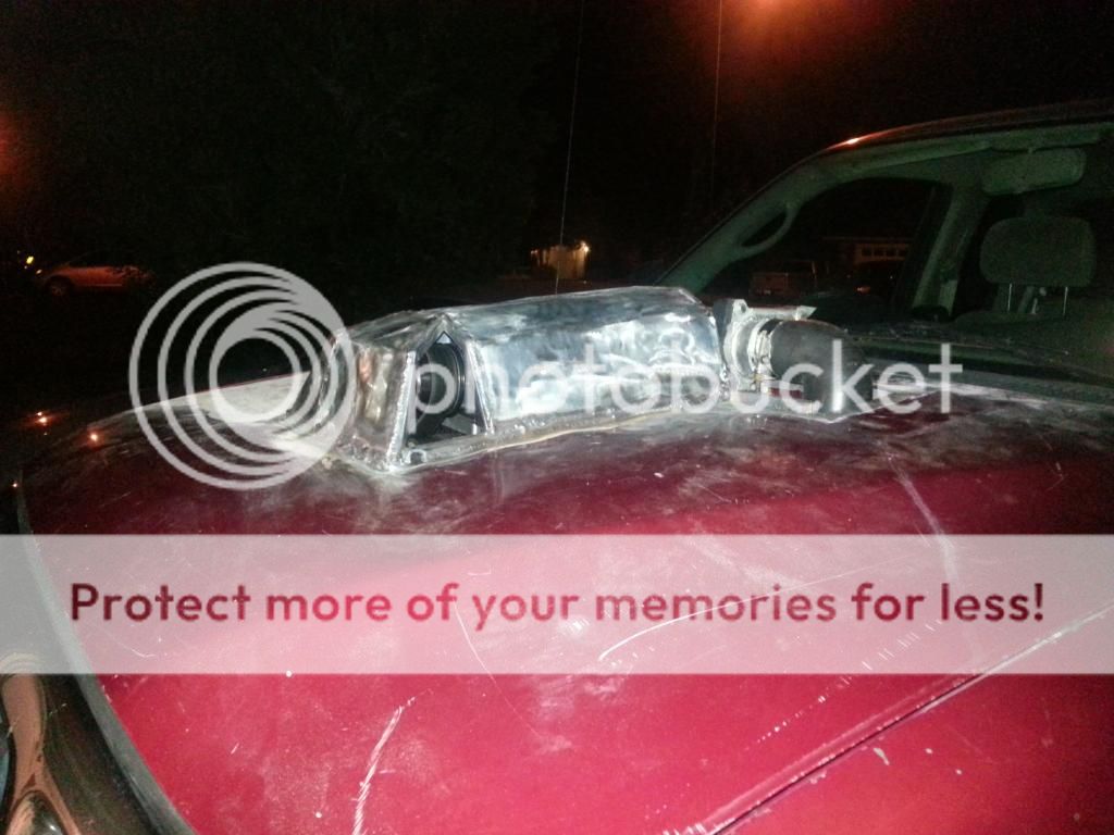

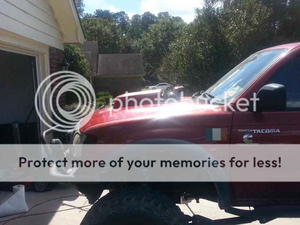

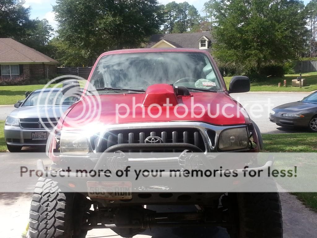

Figured it was time to do something about the supercharger hole, last week it rained hard enough to cool my engine. By the time I pulled into my drive way my water temp was all the way down......
I am debating on leaving the back of the cover open, I think it gives it a cool look. letting people know theres something there lol. I think it would also help cool the supercharger while the truck is moving.

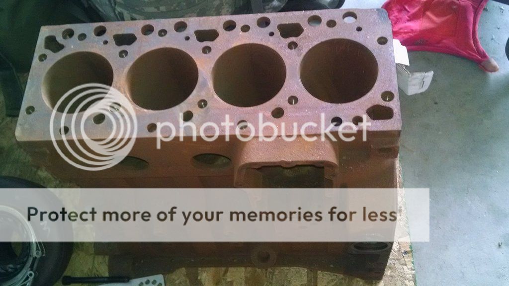

Well I decided to build a new motor, not to sure where its going to end up but its going to have a 4BT block, P7100 pump with a QSB 4.5 head.

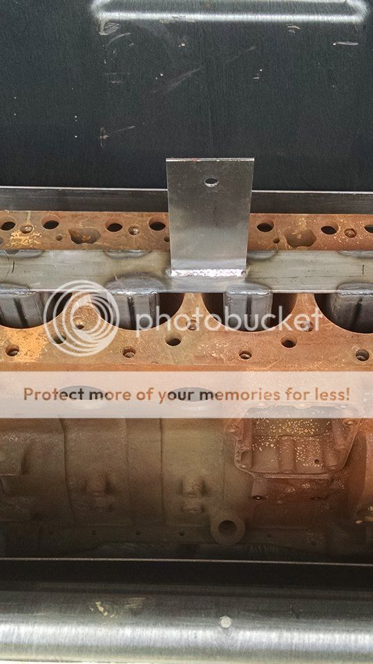

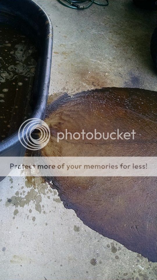

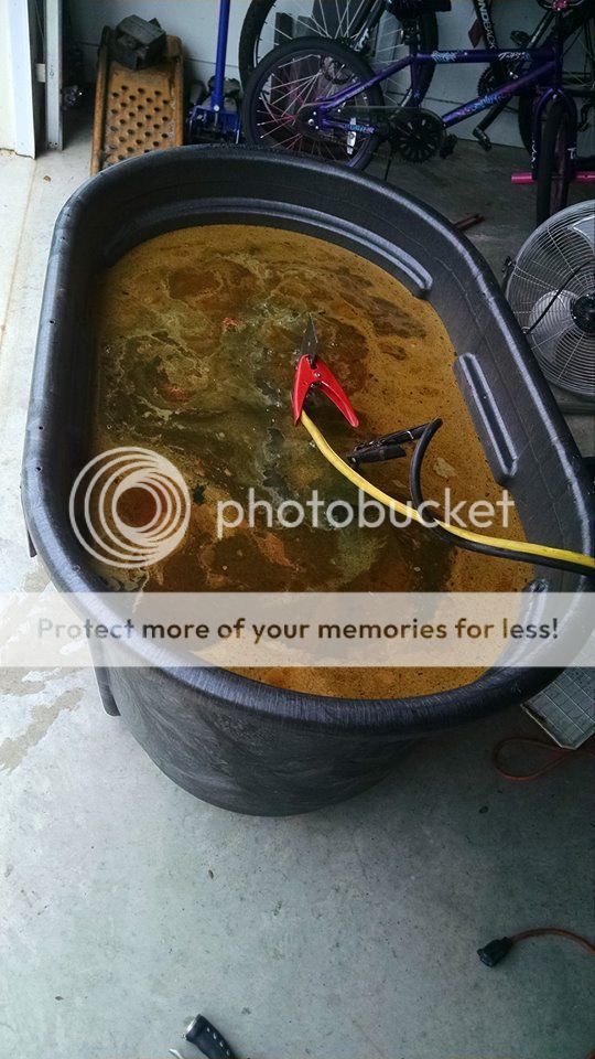

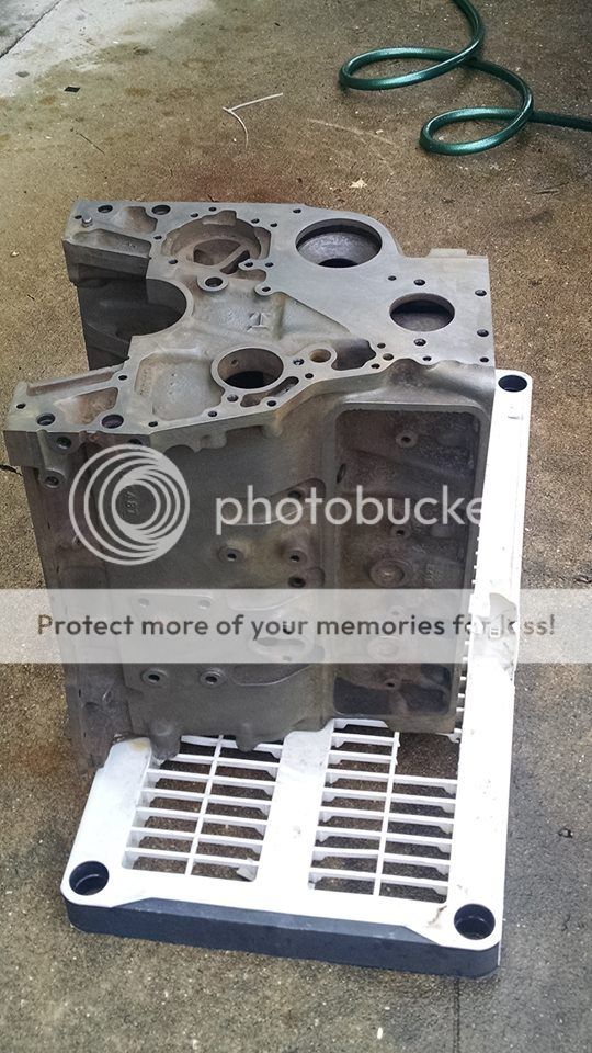

Here's some pictures of the block; made my own electrolysis rust removal tub to help clean it up. Came out pretty good, pulled out a lot of crud that was built up in the block. Only had it in there over night if I kept it in there for a few days it probably would of looked brand new. I used a 24 volt, 60 amp power supply for the electrolysis.
Isn't the 4.5 head a four valve? I thought you couldn't put one of those on a 3.9 because of the water and oil passages switched?
-vr4oaks
Discussion starter · #339 ·
-vr4oaks
Yup its a 4 valve! All of the 4BT block holes line up to the QSB 4.5 head. Now the head does have additional water passages in between the cylinders. I'm going to tap and plug them. Other then that, everything lines up.
Another issue is the injector tip holes are 8 mm, I'm going to drill them out to 9mm. Either use 9mm tips or the 9 to 7 reducer.
This is a slow build, cleaned the block up which is now getting powder coated. Next is getting the head machined in a month or two then pistons. I don't except this to be together until next summer.
On the injectors, why not use the 24 valve Dodge units. They would be a direct bolt in. You'd need the injectors, hold downs, and delivery tubes. Just like putting a P pump on a 24 valve. For pistons, the common rails seem to have a better combustion chamber. Are you sure all the oil passages line up? I looked at using one of those heads and there were several that didn't match. You might could bore holes in the block for the little water passages to match the head. Don't know how critical they are to the head cooling. You might want to compare a 16 valve head gasket to the 8 valve.
