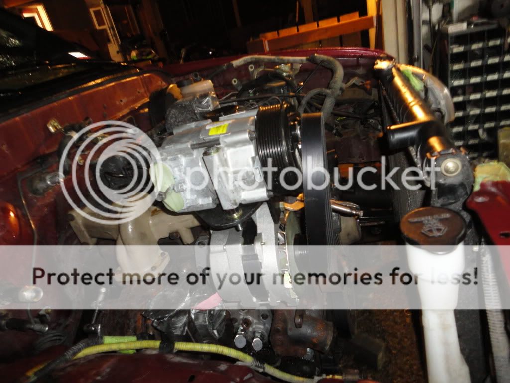

#103 ·
The problems I’m running into now are the compressor housing rubbing against the oil cooler, and the front of the compressor is only 2 ¼ inches from the lower coolant bracket.
I’m wondering how safe is it to grind on the oil cooler to make a little bit of wiggle room so everything can vibrate without rubbing.
And does anyone know of a low profile lower coolant bracket? My Idea is a 4” to 2.5” reducer on the compressor, I’m hoping it will be able to clear but I think I need to move the lower coolant bracket in, if possible.
Ill appreciate any ideas

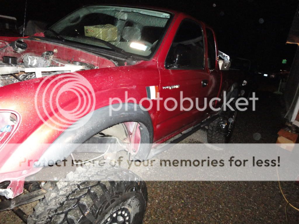

The Specter 62mm turbo is finely on the truck, the eBay T3 to T4I adapter works pretty well except there isn’t a gasket for the middle, you have to use RTV sealant to hold a T3 gasket in place or run without one.
here’s some pics of the final fitment
As you can see the actuator is right over the frame, the fender is going to be cut up to make room for the intake and compressor tube.
The Exhaust flange is from for a HX40, it fit perfectly, I ended up welding a reducer from the 4” HX40 to the 3” I want to run.
Looking at the side of the truck you can defiantly see the turbo! Freaking sweet!

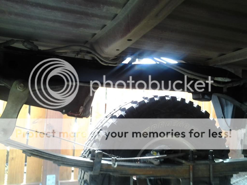

#131 ·
Made a lot of progress the last few days, heres a few updated pics
Trimmed up the fender well to clear the turbo, now the turbo is in full view lol
The down pipe and most of the exhaust is complete, used a flex pipe and rubber mounts to help with the viberations, muffler is flowmaster Delta Flow 50 Series.
Finished up most of the fuel system, I mounted the air dog 2 on the trailer hitch, I’m honestly not a big fan of the design of the pump.
I ran ½” fuel line as well, using the factory studs under the body to secure the line.
