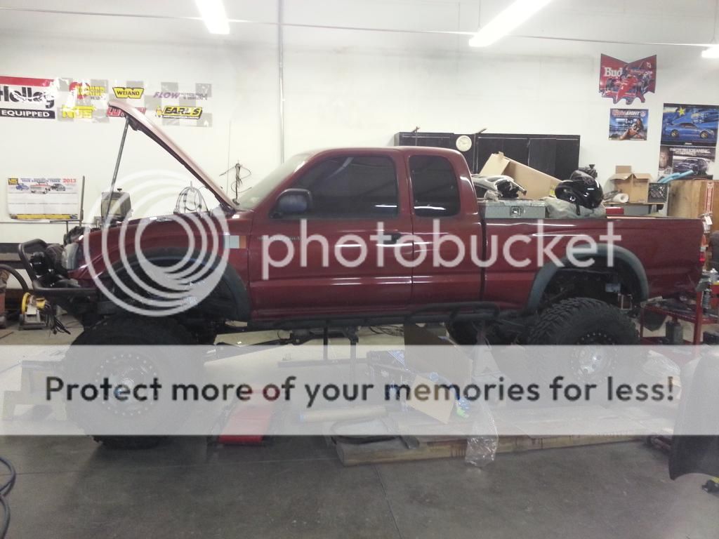

#197 ·

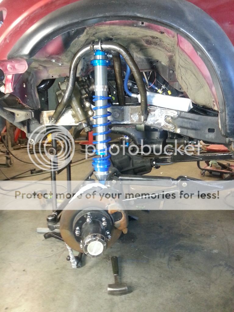

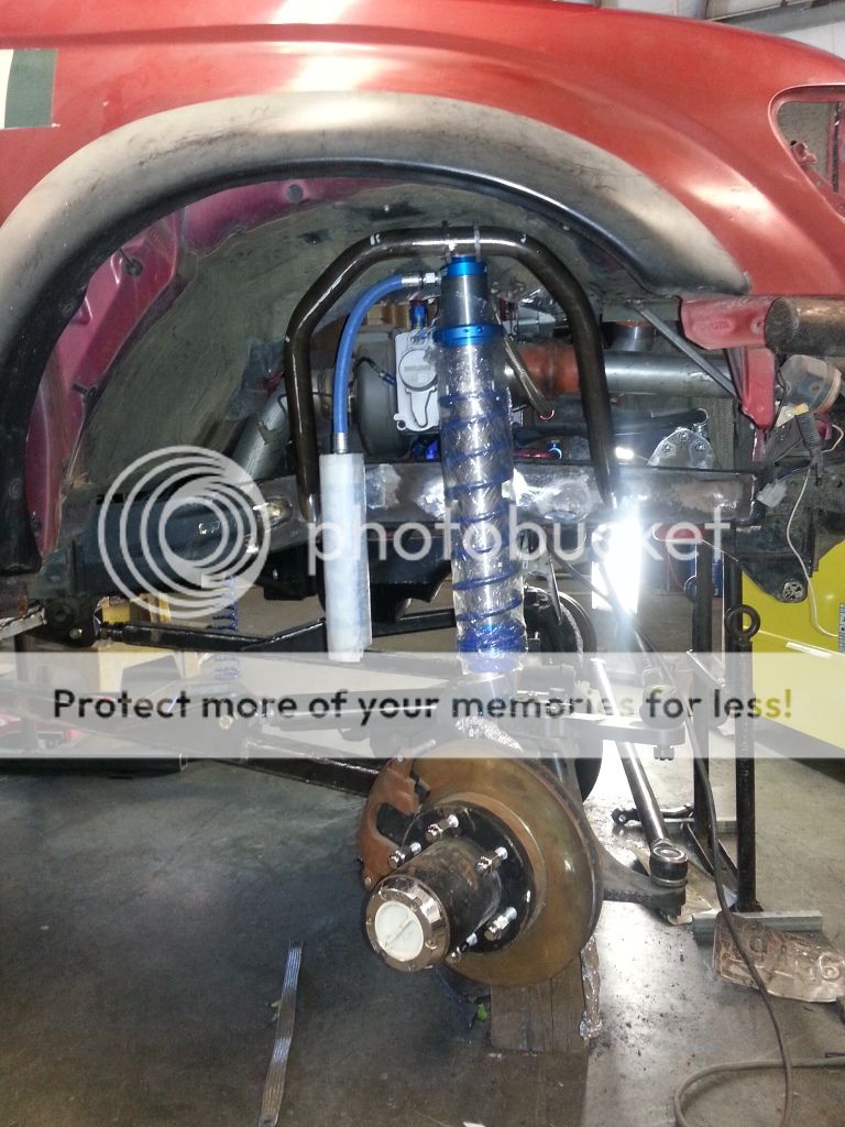

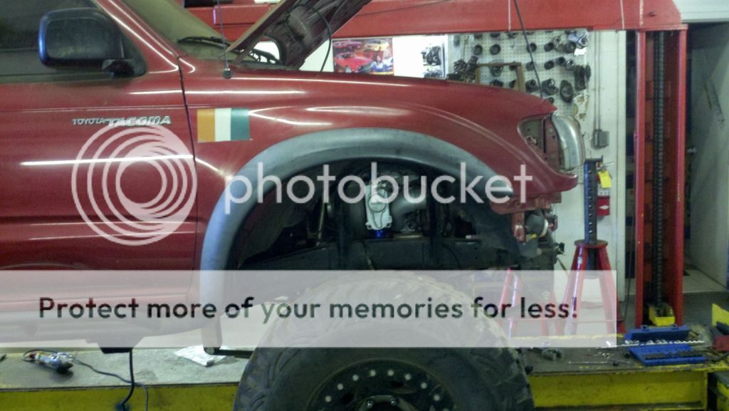

The truck is still coming along, here is a pic of its new stance. The coil over’s and hoops should be mounted in the next few days and it should be standing on its own soon.
Drivers side coil over hoop and tabs

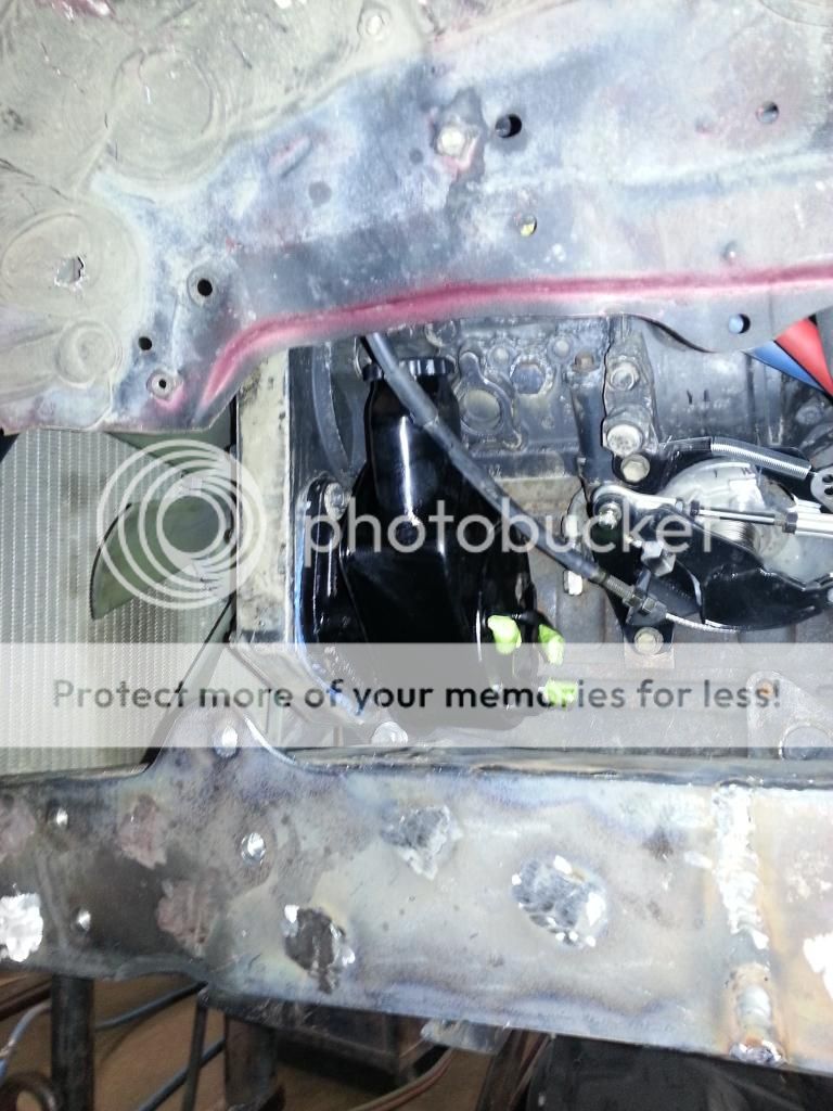

Ran into issues with the power steering housing, ended up swapping the housing off a 2001 dodge cummins power steering pump. Gave me the second return line for the hydro booster.

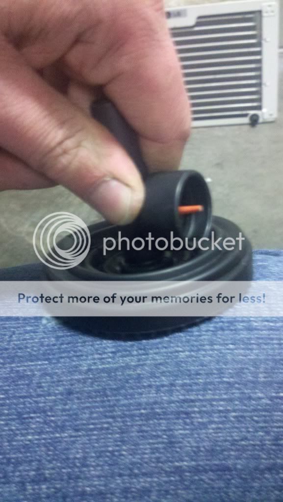

The power steering gear ended up getting moved forward a little more. This placed part of the steering shaft to close to the power steering cap. Ended up modifying the reservoir.

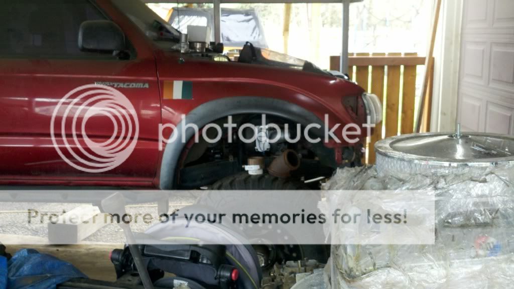

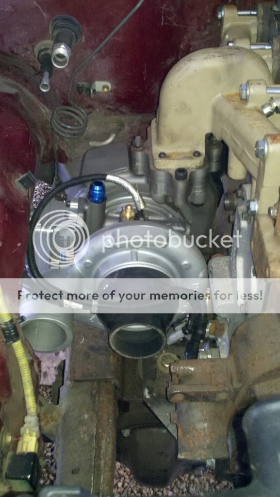

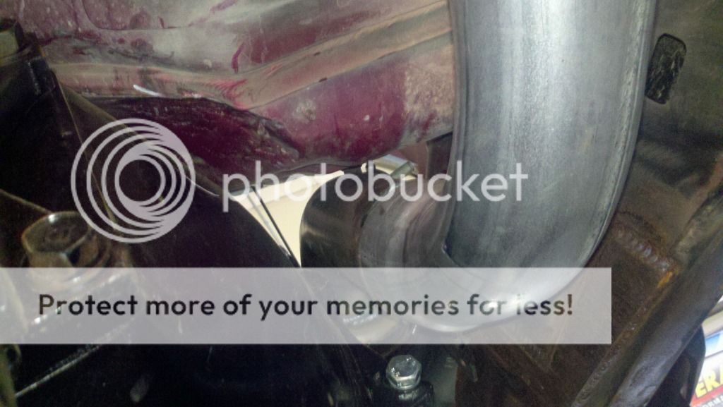

Intercooler is fully installed

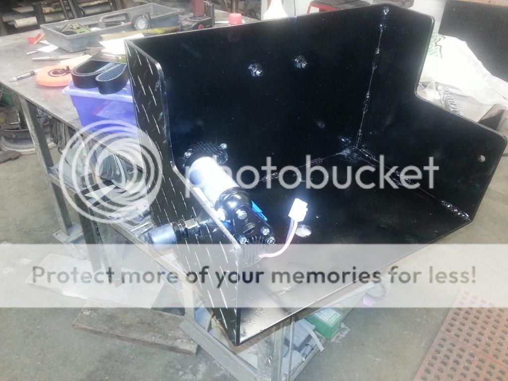

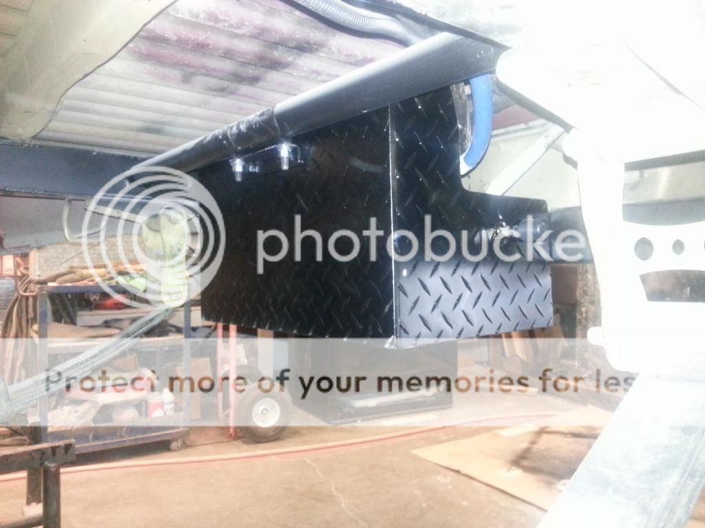

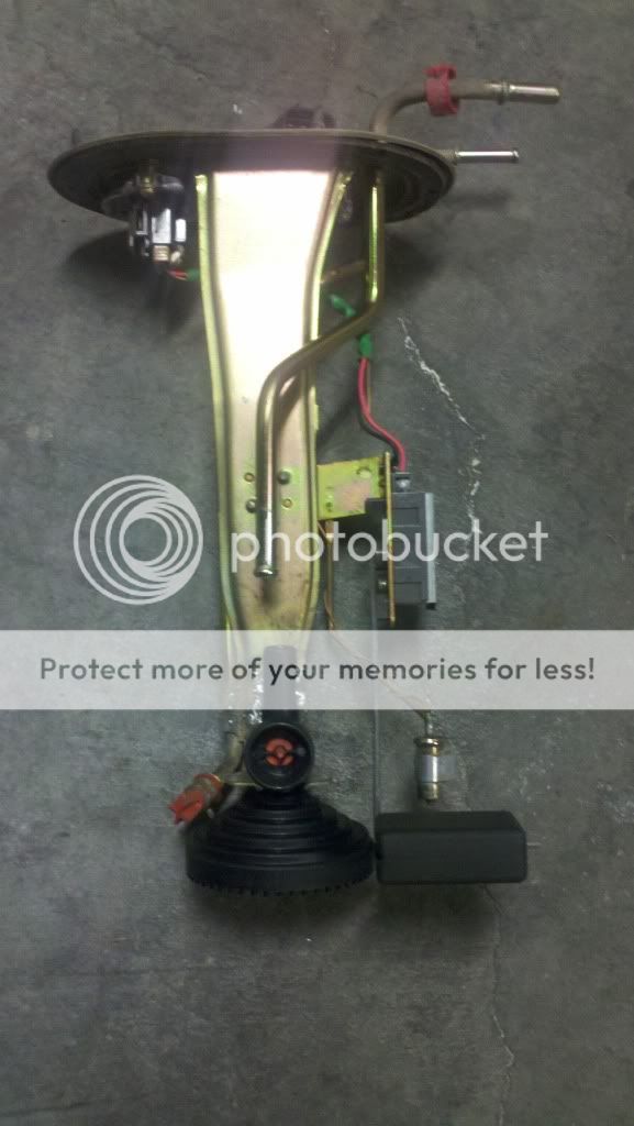

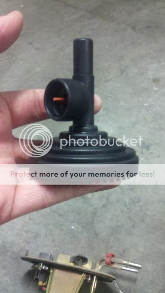

Ended up mounting my ARB compressor next to the fuel pump inside housing.

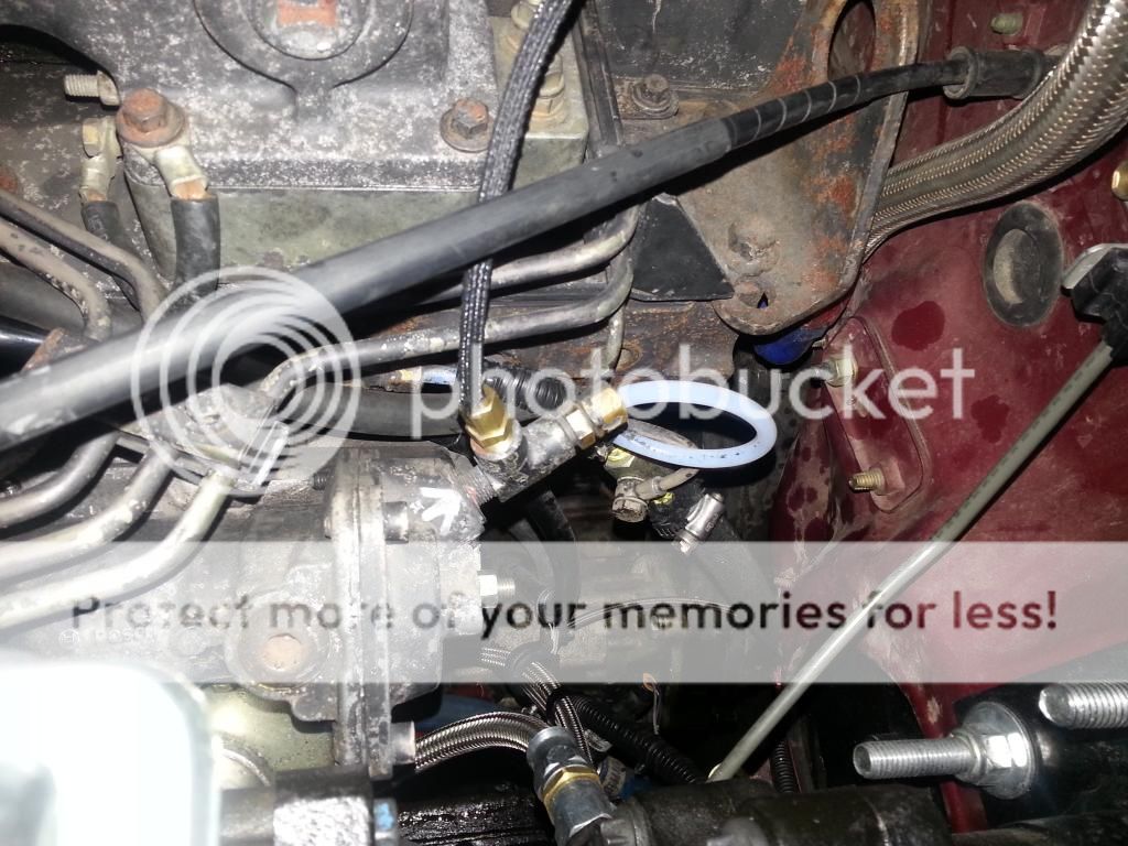

Modified a 1/2NPT adapter to accept the Toyota temp sensor, now my factory gauge works

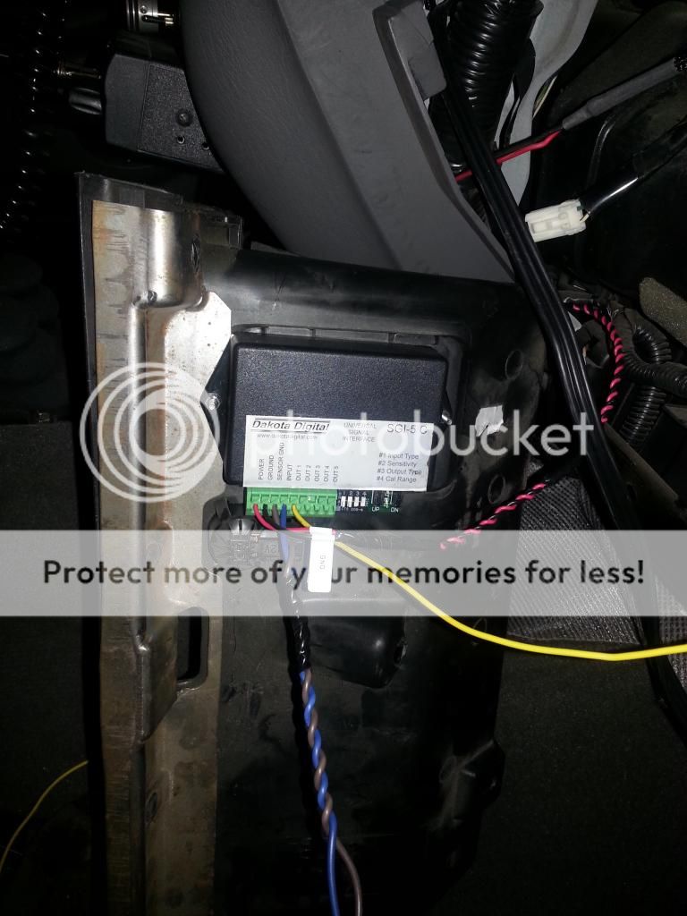

Used a Dakota digital SGI-5 to configure my Speedo, using a 1992 dodge w350 Speedo sensor from autozone in my NP205. Since the truck isn’t moving yet I used a drill to spin the sensor, works great so far.

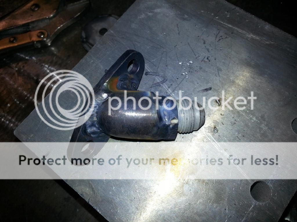

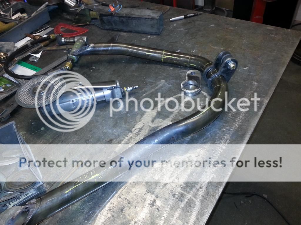

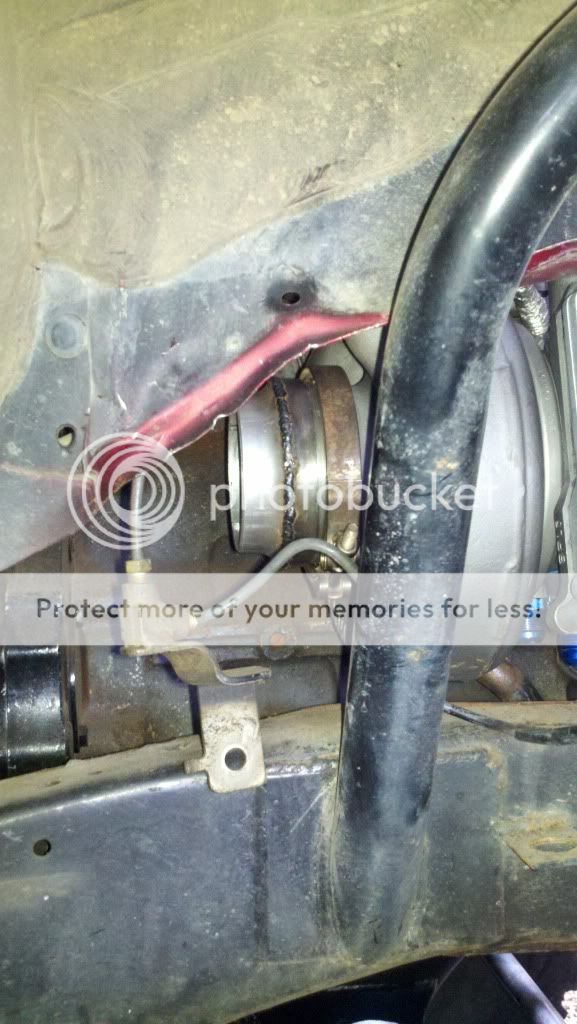

Another issue was my turbo drain tube was way too close to my frame, the new engine mounts reposition the engine a little bit. Came up with a new idea for the turbo drain.
Unorthodox customs are pretty awesome, since I’ve been back from Afghanistan they haven’t had a problem with me working on my truck in their shop. If anyone lives in Washington state, you should really check them out if you need anything made. They can come up with some pretty awesome ideas.

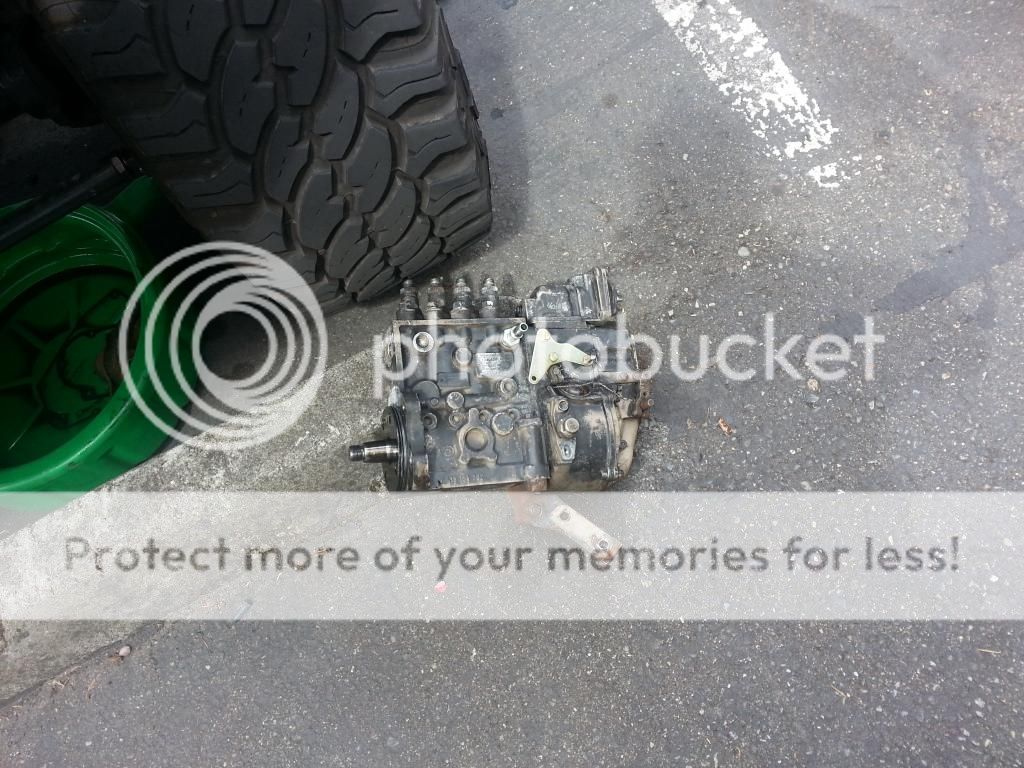

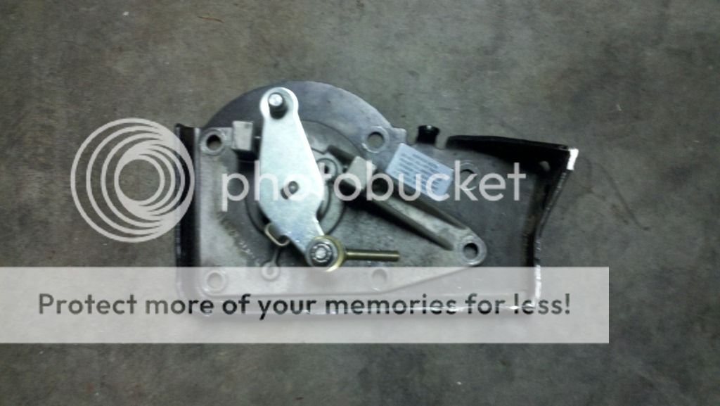

Still tinkering around, just figured out how to remove the injection pump.
Getting 4K governor springs installed, rack plug, advancing the timing 18 degrees and getting a new stop bracket for the fuel shut off since i seemed to of lost mine.
Hopefully this will solve my boost and power issues, or at least get a little better.

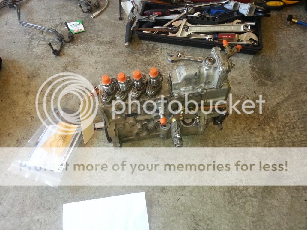

#215 ·

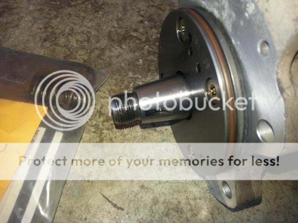

just picked up my injection pump up from H&H diesel, was set at 10* so I had them advance it to 18* as well as install a 4k governor spring. Current fuel settings were tested at 330 CCs. Hopefully this will get my Tacoma moving a little better.
I find it interesting that these pumps are pressed on the gear instead of slotted, although Cummins made a slot in the pump for the gear?
Is there an aftermarket gear and key to help hold these pumps in place?

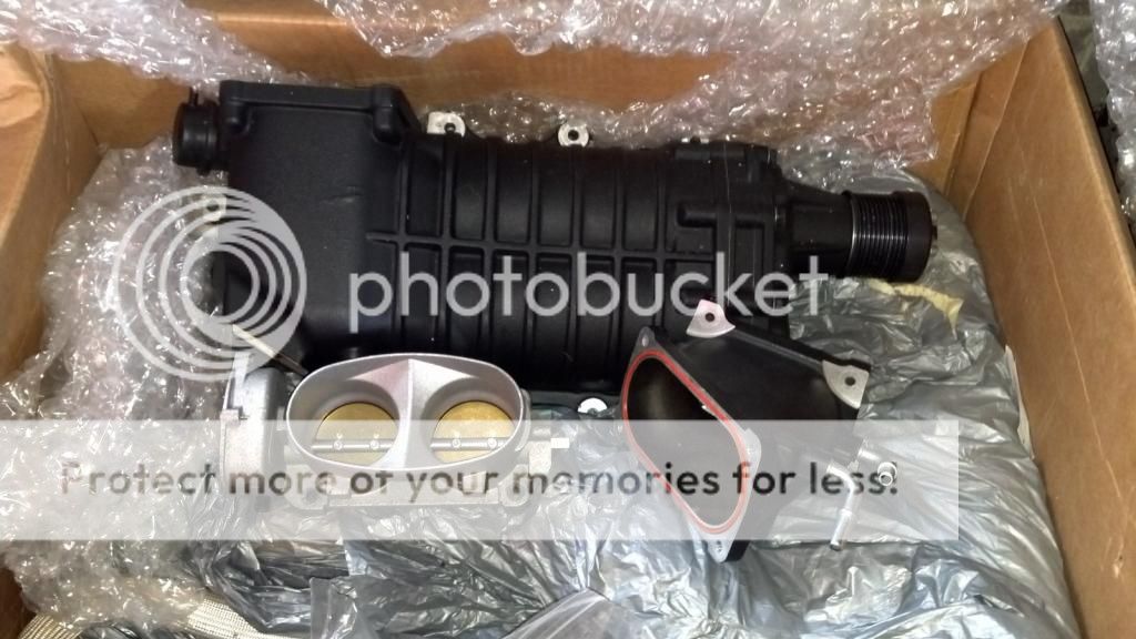

Well I've been toying with the idea of attempting to supercharge my 4BT since i started the build, last night i broke down and starting getting parts lol.
Scrolling though eBay i came across a Eaton M122 for $500 bucks, it came off a 2008 Shelby GT500 with about 10,000 miles on it. couldn't resist :beer:
My plan is to mount the supercharger on the drivers side right on top of the intake, so the turbo will push into the supercharger. I'm planning on rigging a waste gate to the bypass valve, so when the turbo hits 10 PSI it will push the bypass valve open. This should lower the restriction for the turbo.
I'm hoping i can make it idle with 5 PSI from the supercharger then at around 1800 rpms it should make 10 PSI, at this point the turbo should be making close to the same and should take over from that point.
This should also allow me to have the VGT veins opened up more at idle, and in the mid RPM band. Hopefully this will lower drive pressure and EGTs

yeah its going to be pretty awesome, should work out really well with this supercharger and my VGT.

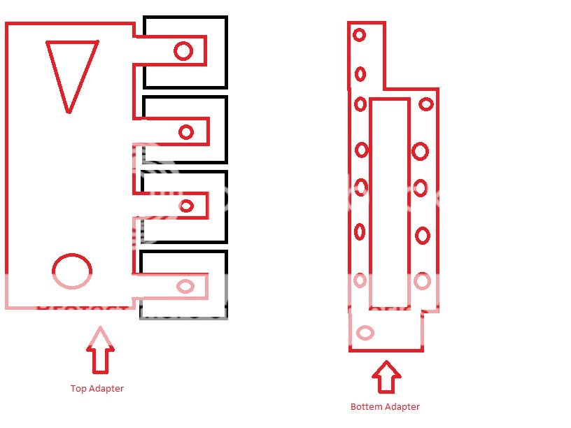

I just started talking to Cobra Engineering, they make some custom adapters for this supercharger. With any luck i might be able to come up with a kit they can machine out and supply the site.
there current kit is $650, and these superchargers with low miles go for $500 and less on ebay. so hopefully for $1200 well be able to supercharger our 4BTs.
here's my idea of the adapter, it will be boxed in from the top adapter to the CAC intake. It will bolt into the top of the valve cover and to the extra bolt holes on the head for extra stability.

On your question about a pump gear with a keyway, the adjustable timing gears have that. You send your gear to the guys and they send you one back with a keyway and adjustment slots so you can adjust to your hearts content. Also you'd want the billet aluminum front cover with the removable ports to adjust without removing the cover. JD's Diesel Performance seems to have the best price. The front cover is a nice piece and would give some bling.

from what i read these go pretty cheap because they dont bolt to anything without alot of custom fab. Seems like i jumped the gun with mine there some on ebay for 200 - 350. all the ones ive seen online have low miles because most of them upgrade to bigger chargers. these chargers are 2 leter chargers, thats alot of air to be pushing into our engines. Im hoping to tune mine so i have 5 PSI at idle and get my turbo to max out at around 30 PSI
