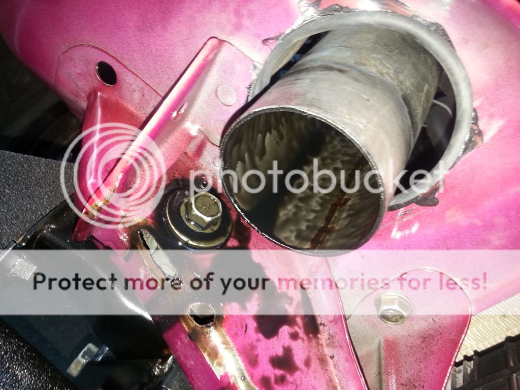

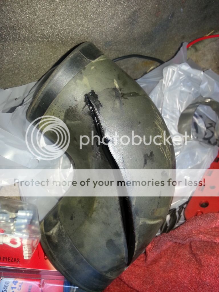

today i blew one of my boost elbows
Now heres the scary part!
Do you guys think this could be from revving the motor up with the 4k governor? I figure its either blown seals or high revving the motor is causing blow by, if its blow by is there a oil restricter i should be running?

Wow, you really ripped through that boost elbow, lol.
Would a sudden decrease in boost, while under load, cause turbo over-speeding, which might cause the oil seals to go? That's a ton of oil in the intake so I feel like you would have noticed that much consumption.
#248 ·
Thats a scary amount of oil. Wherever that's coming form, if its in the boost tubes, I'd be concerned about runaway.

Well i have some dumb luck, the turbo is good. turns out the blow by was caused by a restriction in the turbo oil drain. I must have screwed the line up when i made it, my guess is some of the rubber in the line pealed back when i pressed the fitting in, causing the restriction. I had a new line made, and it fixed my smoke at idle and the oil blow by.
Its a lot more pleasant to idle at a light and not see pissed off people looking at me or worried about getting a ticket lol.
#254 ·
Good to hear it's fixed! What made you think to have a new return made?
Its rubber, talking to the local turbo shop it was meant for intake not a charge pipe.
That looks like one of the intake elbows that came with my motor, so I agree with the shop.
