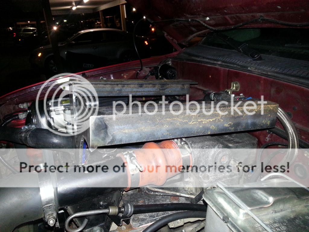

Unorthodox Customs in Puyallup Wa. Has been knocking out the truck little by little, there work is AWESOME!!!
Here’s some pics of their progress.
Removing the leaf spring and IFS gearbox for a radius arm coil over setup by Battlement Fab out of Colorado.
Upper radiator hose to the stock Toyota radiator.
Air intake support
Redesigned the sifters, they said the body wouldn’t support the pressure needed to shift, so they made stronger support for them. Pretty bad ass shifter linkage and twin sticks.
Old motor mount setup
New motor mount setup
Over all there work is pretty awesome!
Ill keep updating this with their progress, hopefully a few more months and ill be heading back to the states.

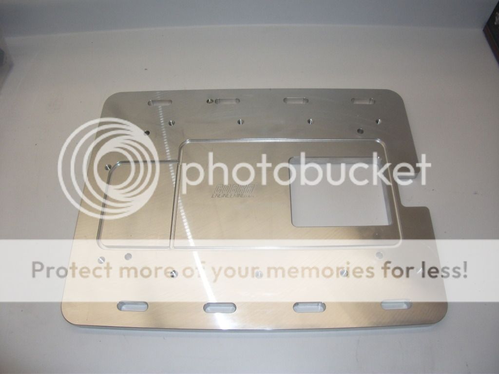

Since I had a little money burning a hole in my pocket I ended up ordering some performance upgrades from MG Diesel Power
Bosch 7x.010” 148* SAC Injectors
Bosch -24 delivery valves
AFC Kit
4K Governor spring
#10 fuel plate
Total cost was $710 shipped, figured it was a pretty sweet deal. It should push me close to 300HP if I’m lucky. Now still debating if I want to pick up a Cam, I’ve read online some people like them some don’t. I won’t be home for awhile so I have time to think about it.
