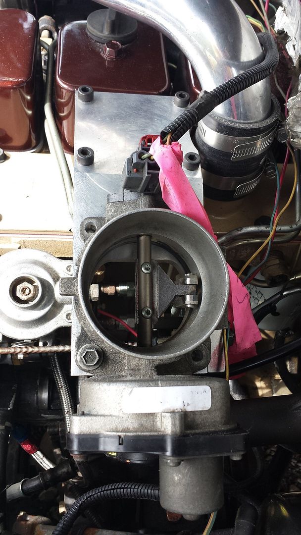

dont know if this helps or not on your throttle, but heres what I did on my 07 ford expedition.
Im having some other electrical difficulties, but I think once they are ironed out this should allow me to utilize the factory cruise, and hopefully some day a high idle control. I have no throttle return spring on the IP. I have very good throttle control. Idle adjustment is also easy as well. utilizing factory TPS as well.

I had a similar thought especially about getting the factory cruise to work since it is contained in the ECM, I have hooked up the hemi throttle body to the wiring harness, it flutters when i cycle the key, but it does not open when the pedal is pushed. The engine is not running during the test so I don't know if that matters but, once I fire it I will see if a tach and cam signal will let the TB cycle with the foot feed. If it will, this is a great way to use existing controls. Thanks for the input.
#63 · (Edited)
Yea I'm not real familiar with how the dodge stuff works. Are you sure the necessary stuff is hooked up for it to function. On.my ford it was plug and play. I do not have any cam or crank speed inputs yet. I machined my balanced for the crank sensor to read from but still no tach. My guess is there's something that needs plugged in for your butterfly to work. I think you should put effort in on getting the stock throttle body to work to pave the way for others that do newer conversions. The only quirk my system has is that whenever you touch the throttle and let off it actually takes it below your set idle and then instantly brings it back up. So...on the original gasser it would actually completely close the throttle body and then reset to idle. Does that make sense?? So if I'm in neutral and give it say a measly 5% throttle increase and then let off it will take engine rpm below idle speed and then back to idle all in a split second. Mines a stick and I don't notice it banging through the gears. If you got any questions or concerns let me know. Some people thought I was crazy for taking my injection pump throttle return spring off but after much testing the ford throttle body has plenty of torque going in both directions. If you need anything machined let me know.
On edit just looked at pics of the dodge throttle body and I didn't notice the TPS sensor on it. Where is your TPS located?? My ford one is on the throttle body. It has the drive by wire wires and also the throttle position sensor on the opposite side of the electric motor. In order for my throttle body to work my TPS has to be plugged in.
#64 ·
I think the tps is integrated into the throttle body and motor assembly unless the computer uses the sensor on the footfeed, not sure. Every sensor is plugged in, i am wondering if the butterfly wont open unless the computer thinks the engine is running.
#65 ·
Project resumed, never thought this project would take me 4 years, since there is snow on the ground, I'm back in the shop.
Next is the AC compressor mount. I had originally thought clearances were too tight to use the Dodge Cummins factory mount, but thankfully there is no interference. With all the accessory drives in place, next thing is the airbox. In factory position, the air outlet strikes the dodge/cummins alternator.
With some modification, I think I can use the hemi airbox. I cut and lowered the mounting tab and rotated the airbox slightly. I will have to fasten the side near the rad to the rad somehow. The hemi air duct should also work, the extra air plenum manifold was cut off and plugged with an ABS plumbing plug and some epoxy. With the help of a 3.5 to 3 inch reducer and some 3 inch exhaust pipe fresh air will reach the turbo inlet.

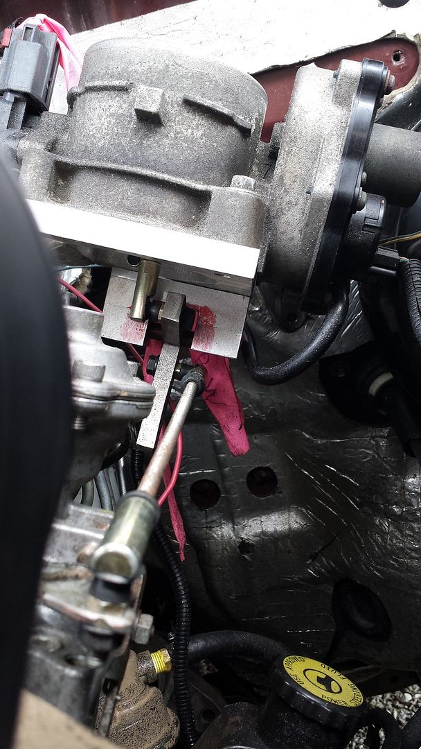

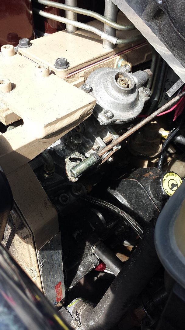

#66 ·
In my 03 ram I took the stock TB, stuck it on the back driver side of the block, and Used a Coupler nut and a cap bolt, cut the head off and made a adjustable length rod which connects to IP arm. It opens and closes completely and uses the stock TB throttle cable arm which I mounted to the IP throttle lever. Haven`t drove the truck just yet, but I`m off for 2 weeks for Christmas and New years shut down, plan to get some real work done then. I doubt the hemi and 4.7 are to far apart, I know my air box according to S&B uses the same filter up to the 8L V10 dodge had. So our boxes should flow plenty of air.
