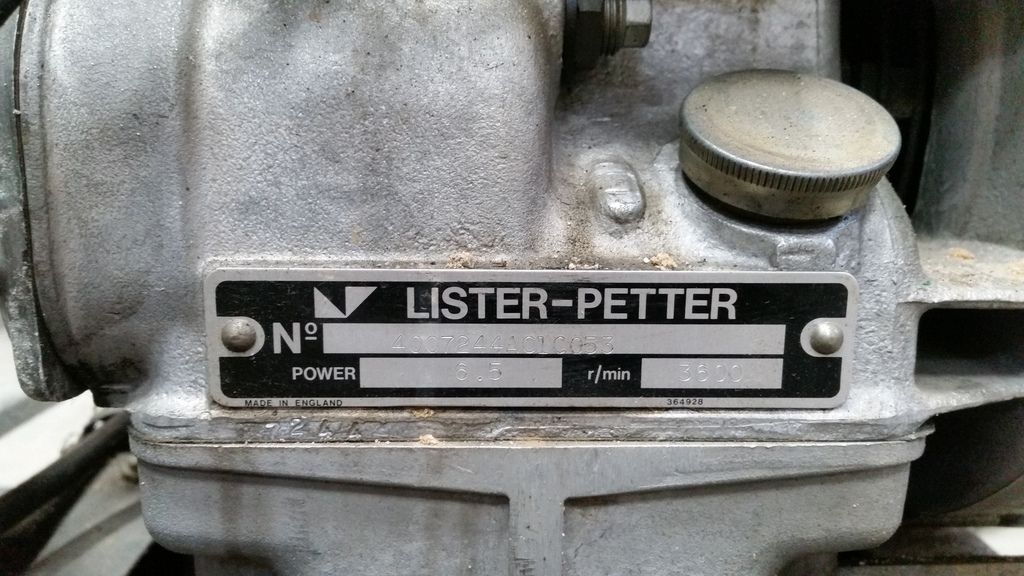

I recently acquired a single cylinder air cooled 6.5hp lister that's destined for a super split log splitter similar to Grigg's repower with a baby kubota. I'm hoping someone here might know a little more about this thing than I do.
I don't see any type of throttle control, just "run" and "off". The tag lists 6.5hp at 3600rpm; I would really like to run this thing around ~2000rpm as that should be all the torque I need to run the splitter and not turn diesel into excess noise. That even possible or just run it as is and don't touch it?
1,384 Posts
That is certainly an AC1. The AC1 has a 3" bore, 2-5/8" stroke (304cc) displacement. It produces a maximum of 11.6lb/ft torque @ 2500rpm. The tag shows that your engine was built in 1990 and is the 7,244th AC1 built. It operates in an anti-clockwise direction and has a spec number of 53. Your engine has a fixed speed governor, and is adjustable from 2200 to 3600rpm. The blower inside of the flywheel will not produce a sufficient amount of cooling air flow below 2200rpm in a loaded state. I can probably send you a copy of the service manual for that engine. I have collected quite the library of Lister literature over the years,

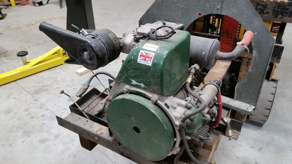

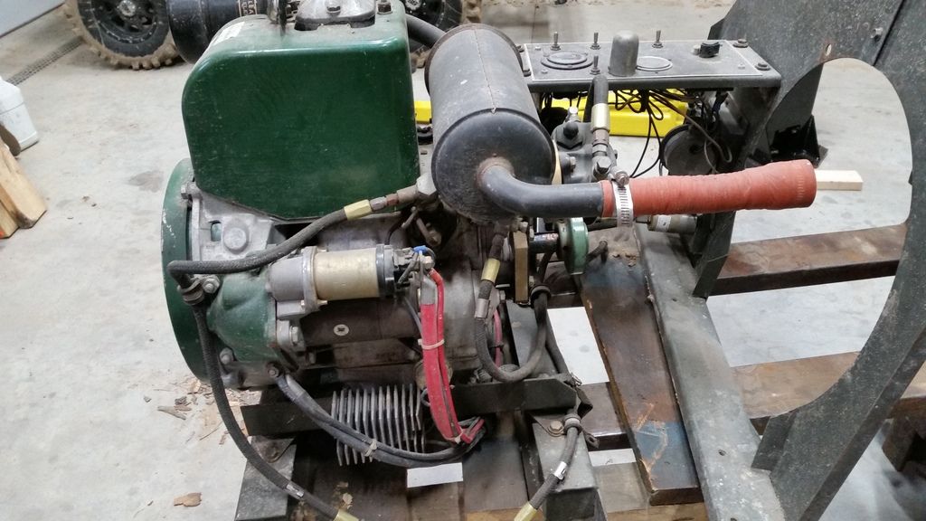

Playing tetris on my pallet rack tonight, the damn piece of left over sheet metal enclosure was literally 1" too wide. So I decided to pull the lister down and strip all the crap I don't need off it. Put some fresh oil in it, hooked up a battery and she cranks over perfectly. Sweet!
If anyone wants anything in the picture, hit me up and just cover shipping. I'm only going to keep the filter base and hose ends.
