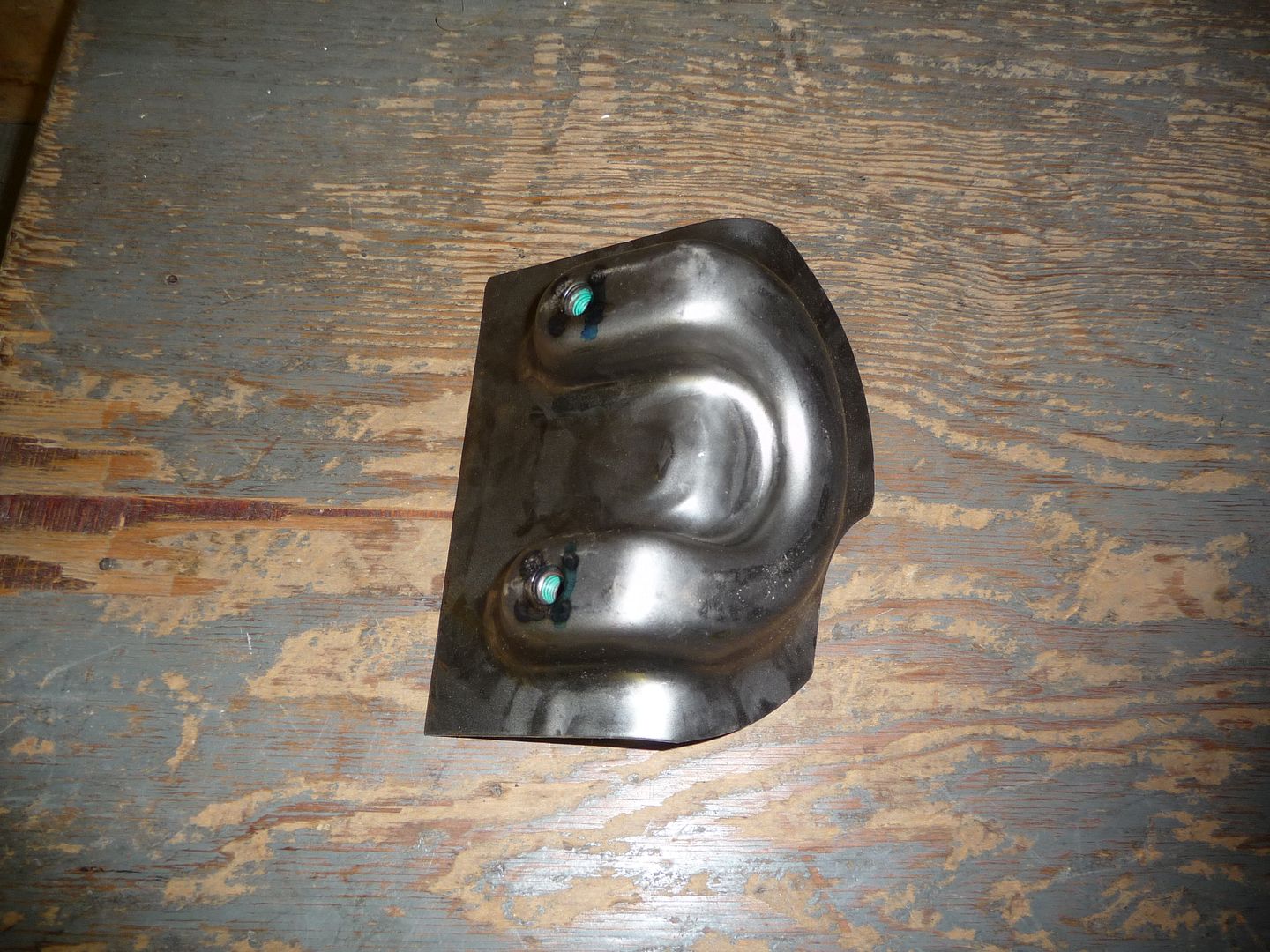

Hole saw time. I cut 3" clearance holes for the IC piping. Unfortunately, I had no choice but to hack through the two main vertical supports. i'm sure i lost some rigidity here but, any further out and the clearance holes would have come too close to the fenders and lower turn signal lights. This was a massife pain to cut as my hole saw wasnt "deep" enough to reach through the entire support. I had to cut each side individually, then finish everything up with a cutoff wheel and air saw.
The Intercooler was mounted by drilling two holes through the top of the core support. It's hung by two pieces of m8 all-thread and supported on the bottom by one of the (modified) original core support tube x-members.
