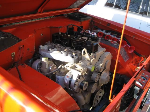

So yesterday went really smooth got the motor bolted down and tranny bolted as welll i am going to wire it put radiator in and finish a bunch of other bs though. I am going to fire it up one firday Hopefully check out the pictures will get more soon.
Two problems: The hydroboost master cylinder hits the pump Cant move it over any any suggestions on a quick fix.
also Any good tips to bleed the injectors

Looks great! Depending how it interferes, you might try one of the later model cast aluminum master cylinders. They seam narrower than the older iron ones.

The master cylinder is meaty....I would introduce it to a grinder.
Loosen the injectors 1/2 turn and crank it untill you have fuel running out. Tighten and it should start in a couple seconds more of cranking.

Ditto on the grinding. You should be able to 'adjust the clearance' with a grinder... Also, I don't know if it's possible, but what aboud making the mounting flange thinner?

I was also gonna say a shim. I've seen a wedge-shaped shim that put a couple degrees of upward tilt to gain a 1/4 inch. (Shim at firewall/mount)
Is it possible to elongate the holes in the firewall for upward movement w/o messing up the geometry?

I buy my Hydroboost units from Hydratech.com
I was going to have a interference issue on my Carryall between the Hydroboost ant the IP Pump. Paul at Hydratech made a special mount that gave me a few degrees up tilt and a few degrees to the left. Fit like a glove with room to spare.
Here is a link to my Hydroboost pictures. In the album text are the degrees of angle Paul added to the custom mount.
