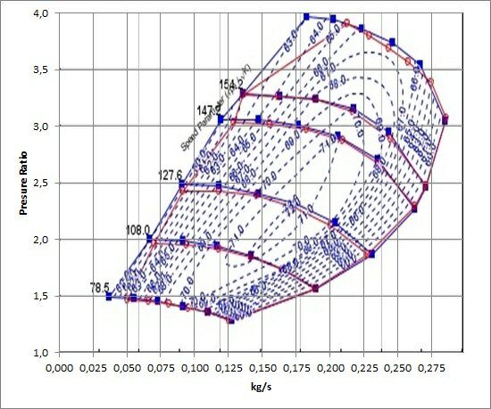

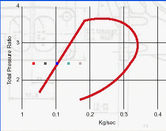

According to these compressor maps, at a pressure ratio of 3, the HE221W flows approx 0.28 kg/second verse approx 0.34 kg/second for
the HX30. The HX30 can flow nearly that at a pressure ratio of 2, where the HE221 flow rate is down to approx 0.23 kg/s.
