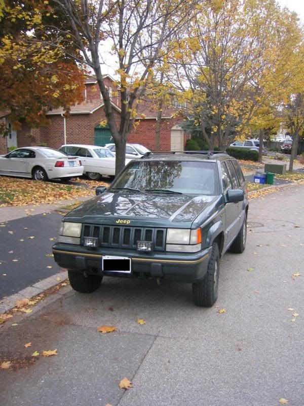

The ZJ itself:

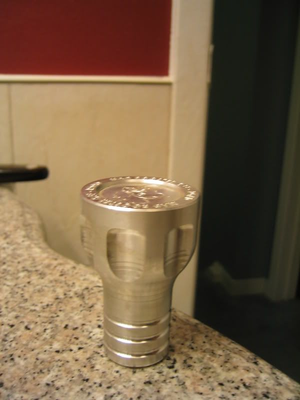

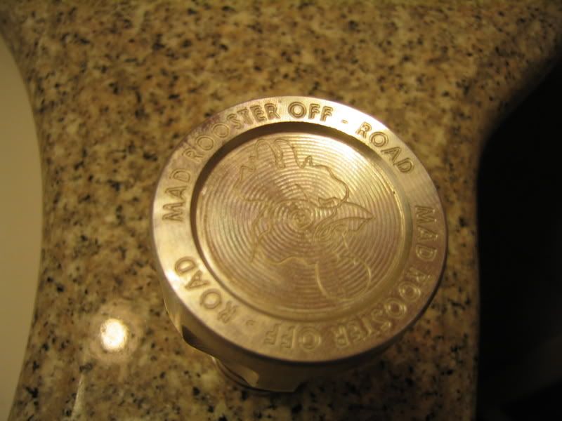

Crawl Box is here and came with a blingy shift knob too.
What is a crawl box you ask? It's basically dual transfer cases. You take the front half of a 231 and with the adapter plate and input shaft, mate it to a D300. This gives you a front case with high and low range and a rear case (that will be twin sticked) that gives you front/rear high, neutral and low ranges. Plus thanks to the front case your Low range or Low Low (both cases in low range) is 7.13:1 (add a 4:1 low range to the D300 and it changes to 10.88:!, awesome for crawling).

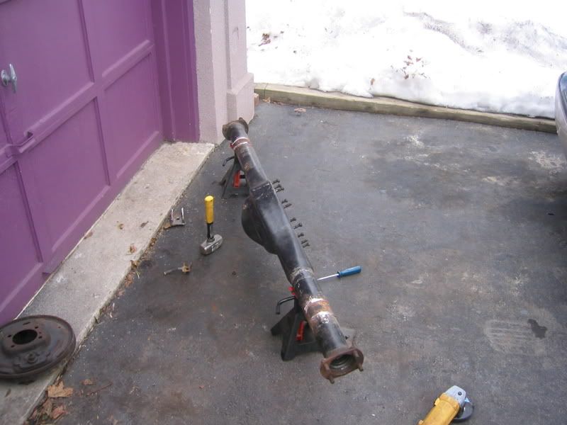

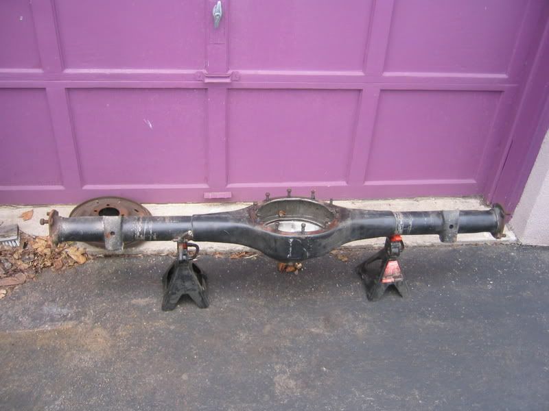

Got the 9" housing home today.
Started working on it, ground the spring perches off.
It is a big bearing 9" too!
Here it sits with the perches knocked off and after cleaning it up with a zip disk. Used some mineral spirits to clean the dust and dirt off and now it's ready for paint.
