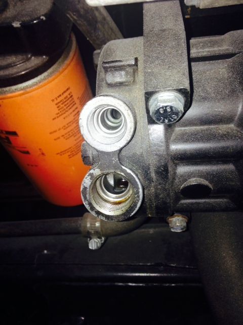

So I'm not getting anywhere with Old Air on obtaining the fittings I need to connect this compressor (was purchased as a Sanden 4474) to their universal hose kit. Is there a a manifold or adapters that connect here? I'm not sure what to ask for, or where to get it.

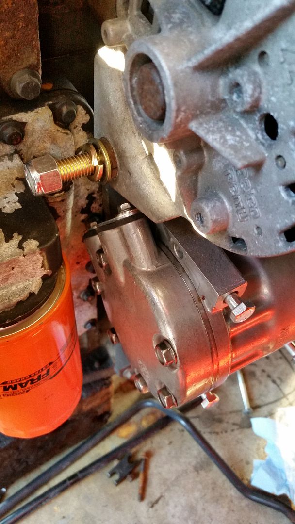

Don't know if there's much frame difference but here's some photos of the high mount system in place in an '87 blazer. You'll note this engine has the vertical oil filter. Don't know if there's any issue with the horizontal one common on most 4bts. Back of the ac compressor and oil filter are close as you can see. Also, here's a photo of the complete assembly on an engine. This one has the Ford inlet pipe.

Here's some photos of the same setup in a C20. I also have some dimensions in there for the AC hoses to match up to an 85 condenser.

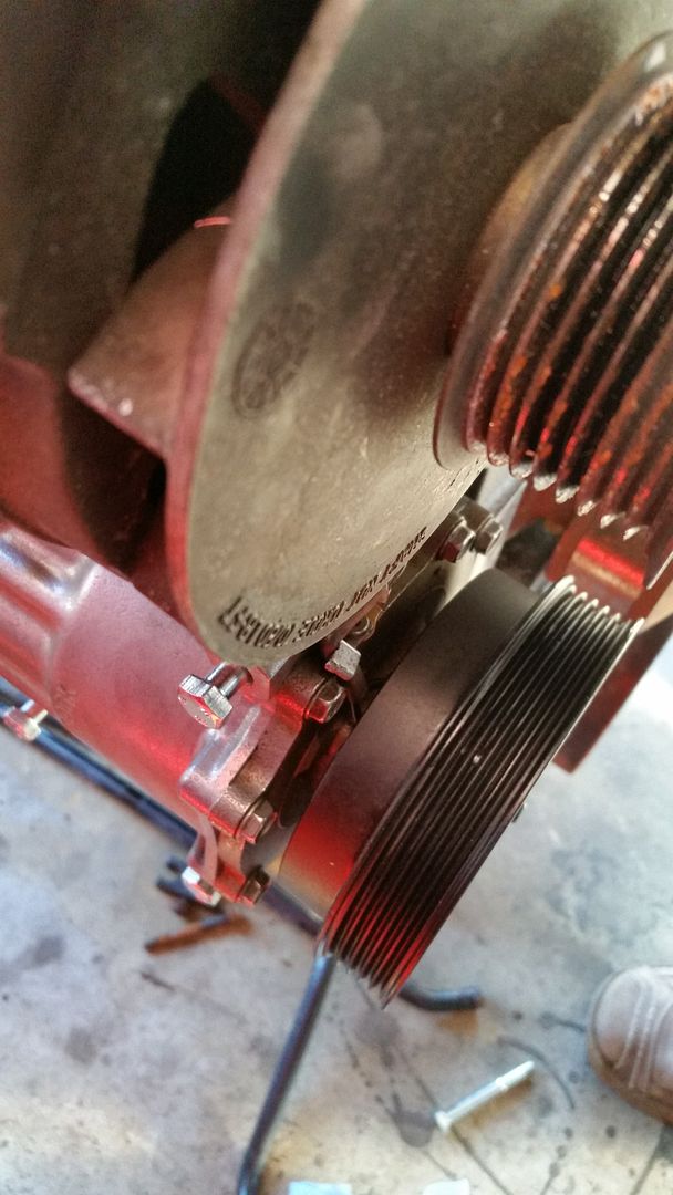

I was lucky to find a 1st gen CAC equipped 6BT fan pulley and mounted it to a 3rd gen bracket to get the clearance needed.
12,996 Posts
Subrutus, that is interesting. Those shorter pulleys use different mounts so the belt alignment is correct. Only the '91.5-93 engines used it. Here's what the 2 pulley designs look like. Didn't realize that pulley would fit the 3rd gen mount. Learned something new. I have one of each of those mounts and never thought about the early pulley might fit the later mount.

I gave it a try and it works.
