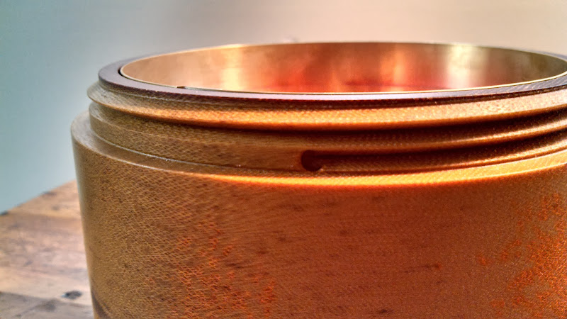

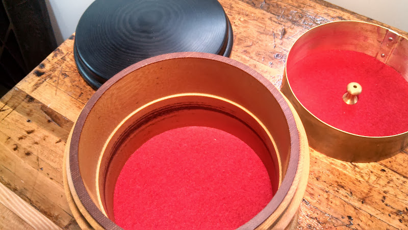

I turned this out for my wife for Christmas. It's made of Micarta which is layers of cotton or linen cloth bound by a phenolic resin, commonly and originally used as an electrical insulator, gears and other mechanical stuff, and more recently used for knife handles.
I forgot to get any in progress pictures but after roughing out the pieces on the saw the rest was done by on the lathe (not CNC). Outside diameter is 6" and the treads are 6 pitch. The removable tray is brass silver soldered together, when putting it back in the box it slowly falls into place as air escapes through a vent hole in the center knob.

Beautiful job Grigg. I think I know the same material as orcot.
How did you get such a clean finish to the thread?

I used some carbide tools but the threads were cut with tool steel I ground and sharpened quite keen. It machines very well, finished with some simple oil wood finish.
