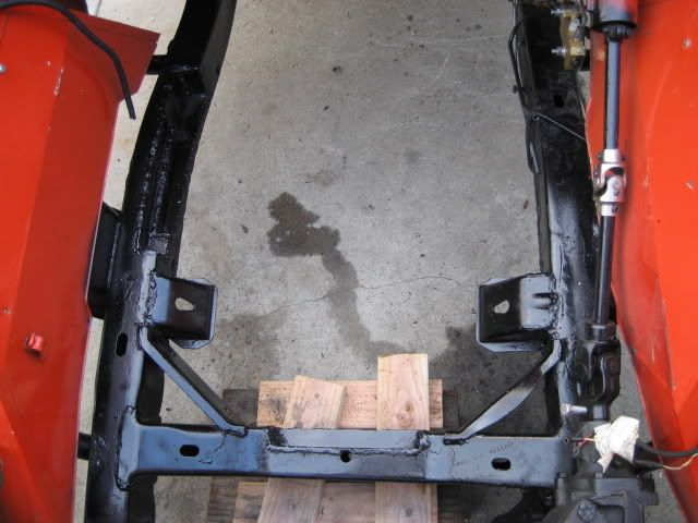

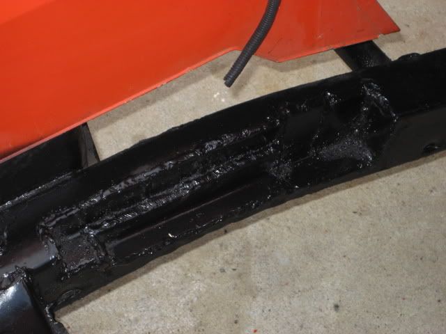

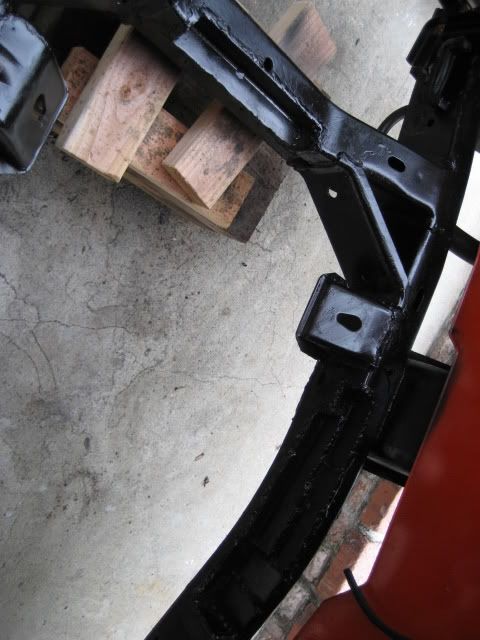

Hey everybody almost there the mounts and notching is done in the frame had to cut out about a 12"x2x2 notch for the starter and a 6"x2x2 for the surpentine belt i just made my mounts this weekend they turned out really well (IMO) alot of my welds arnt pretty but there strong as heck any how take a look at the photos and let me know what you think i will be building tranny mount this weekend and wireing everything should be going soon i am getting really close. Everyone who is still working just stay motivated it will work out for you sooner or later

I took the whole front end out and set the frame on blocks so it is easier to drop the 4bt in it is to big of a pain to chop the inner grill out or even remove it.

Nice work!!! The angled manifold will work out great on a Bronco. Hope to be back working on mine over the holidays.

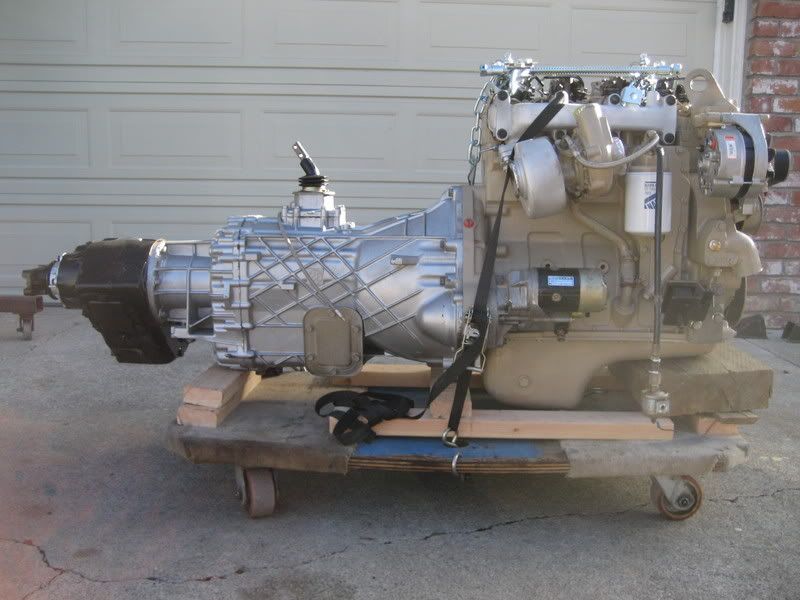

Are those stock Ford motor mounts? and is that a ZF6 -650 or a ZF 5 trans?
thanks
