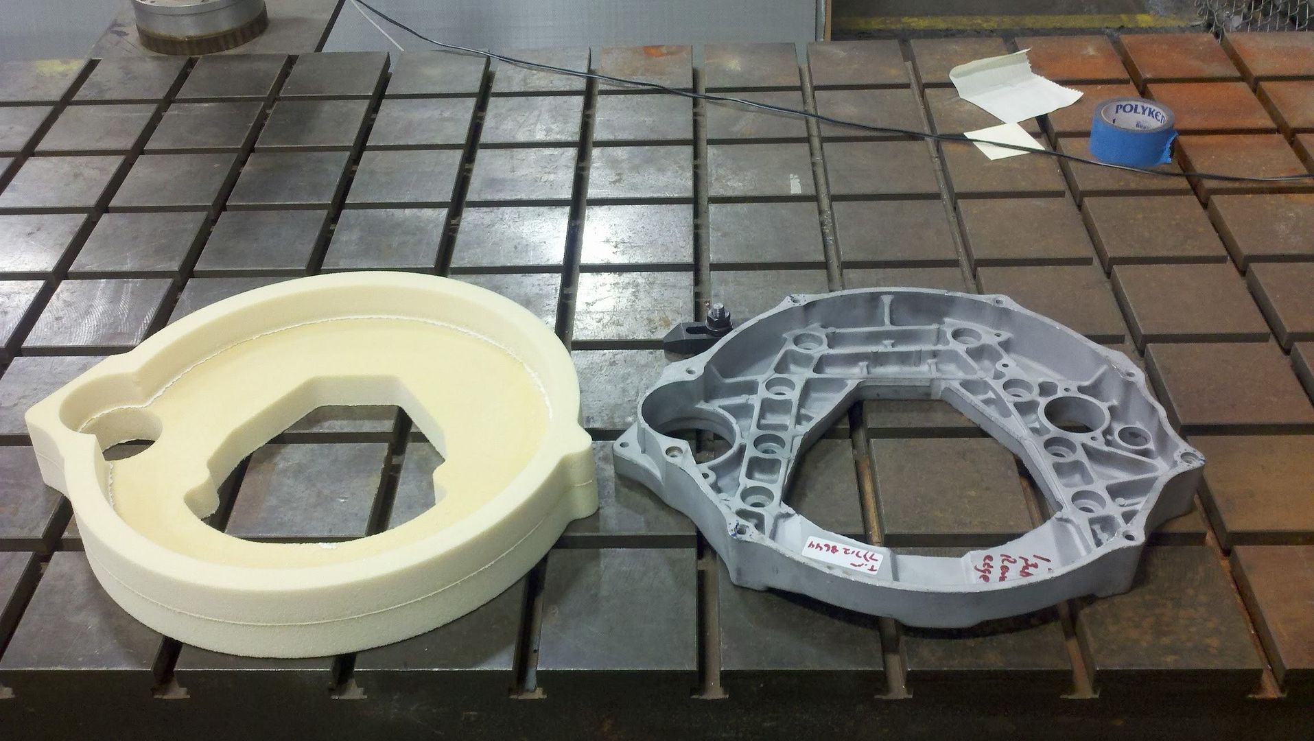

#61 ·
Ok, for you Ford guys, I got a nice piece from Roostre last week and it looks like it might work out just fine for the BB Ford guys.
http://i273.photobucket.com/albums/jj236/dieseltim/2012-03-31_19-27-42_97.jpg
http://i273.photobucket.com/albums/jj236/dieseltim/2012-03-31_19-27-33_11.jpg
These are just mockups but it gives you a good Idea of what I have going so far.
I am still waiting for my pattern to be milled but for the price I can't get in a real big rush. I hope to see a test part made from foam by the end of this week. If it all looks good then the pattern should be ready for the first test castings in a few weeks.

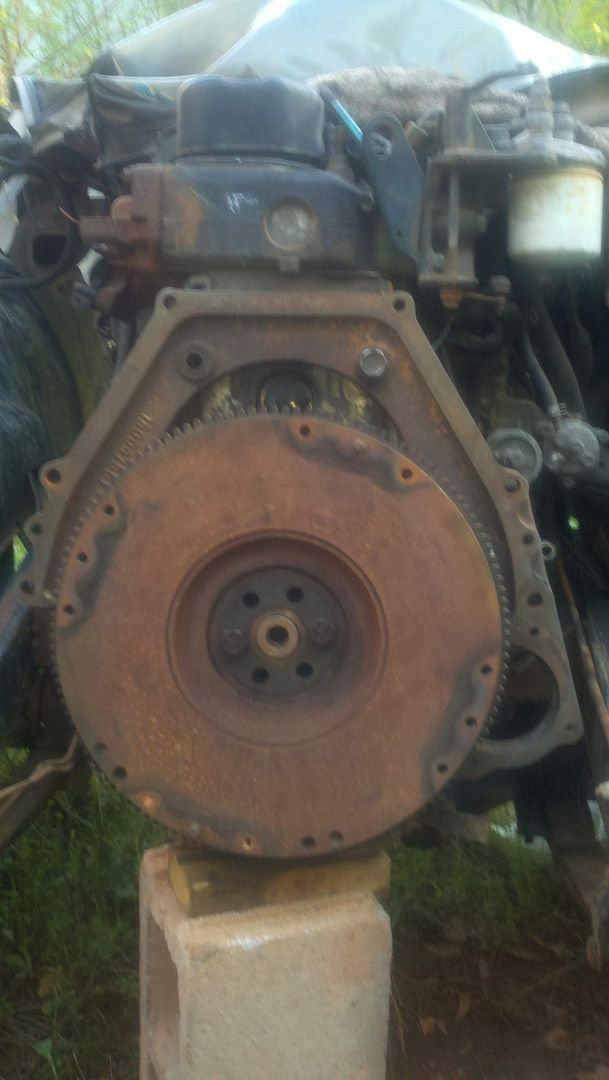

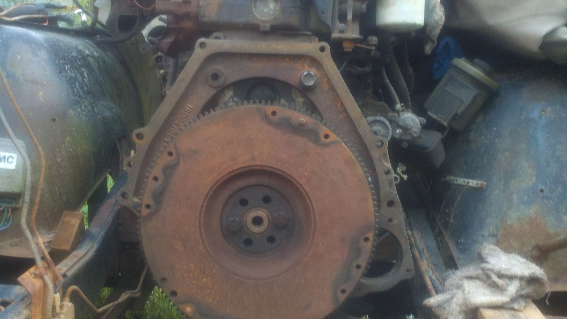

#63 ·
Well, 2 of the holes are really close left to right but I think that they come out some where in between vertically. I will have to have a transmission to find the center line and then locate the adapter to center on the C/L of the crank. As for the starter it is going to be really close to the engine block and the oil filter will have to be relocated with this adapter as well. Looks like it is time to start making oil filter relocation kits as well.

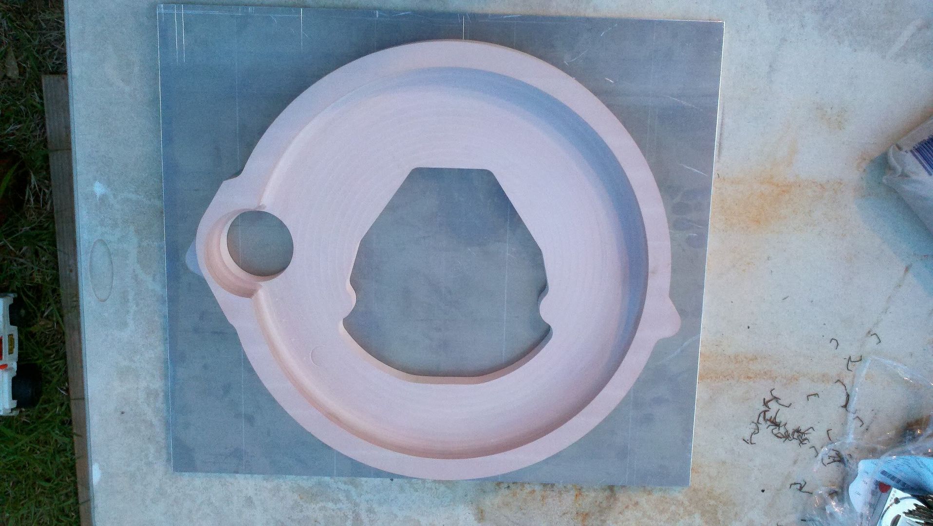

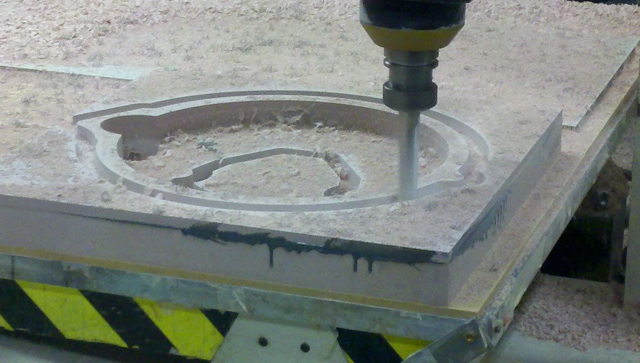

#71 ·
I know everyone is waiting to see how it is coming along. As usual with projects like this, I have had a few problems to overcome. The largest problem is that the casting Company in Va. that I had been dealing with has not been real helpful and has cause several delays and wasted a few Hundred dollars of mine by not giving me all the info that I needed to get this finished. I am meeting with another casting company that is a bit more local (at least they are in the same state) this afternoon. I have the CNC mill standing by and ready start milling parts ASAP.

#74 ·
Ready for casting
Well, I forgot to get any pics before I dropped off the pattern today at the casting company. They said I should have the first test parts by next week. So, for everyone that has been waiting for a Dodge adapter, it looks like they will be ready very soon. I hope to have the first units back from the machine shop by the first of June. Once I have these first ones test fitted I will be taking orders and shipping them out ASAP.
