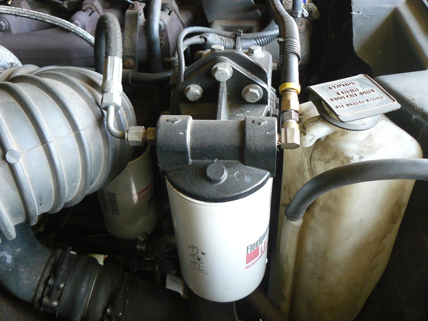

Mine will use an LF504 Military Senior housing which I already have, with a .50 micron absolute filter element. Pressured feed will be Flex line to hard line tapped into one of those plugged oil gallery ports on the driver's side of 4BT block, the plugged bosses just below injection pump, above oil pan rail; think there's 3 of them there? Return will utilize the freeze plug with U shaped cast boss having bolt holes not yet threaded, below those oil galleries and above oil pan rail on driver's side. That's an unpressurized return port to pan.
The .50 micron absolute filter element insures no noticeable change in oil pressure and thereby allows super-cleaning of just a sample of oil to be slowly filtered, to work over time, not immediate large micron filtration that's actually useless to bother with.

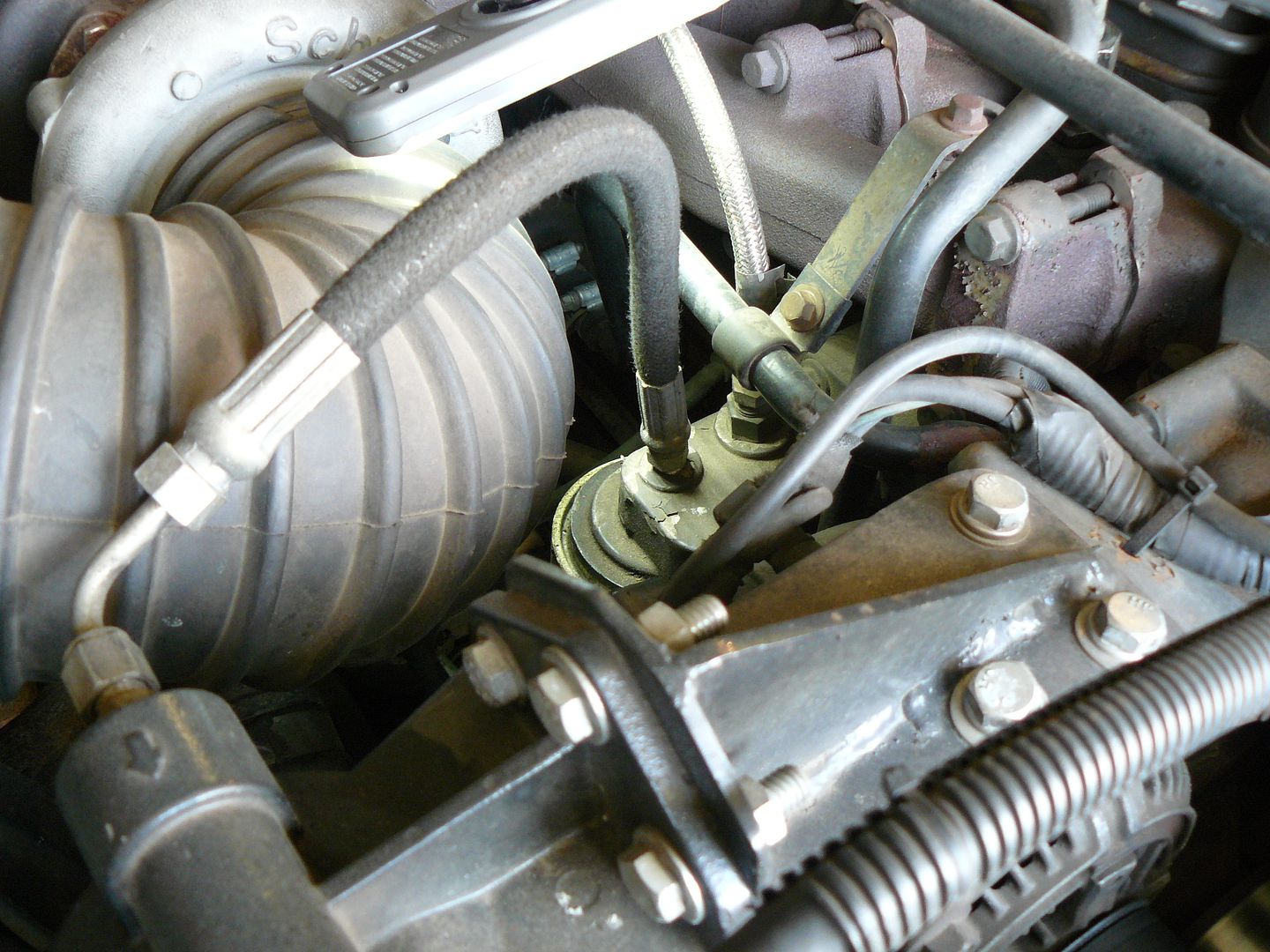

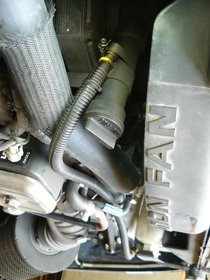

I did similar to Redhead on my 6bta. Got a filter mount, filter, and had hoses made. I don't think I have $50 in it. I made a bracket and bolted it to the alternator mount, it dumps into the oil fill tube. I need to get some pics I guess.
