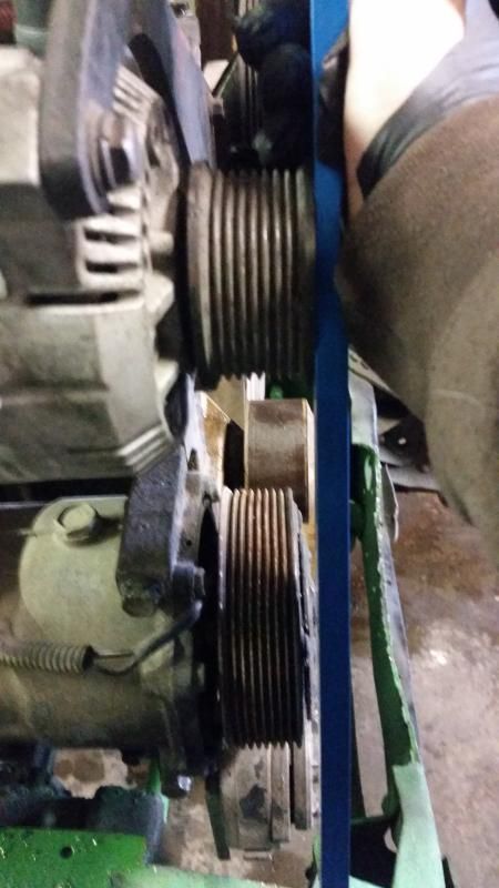

The smooth pulley started out as a ribbed one that was on the bus motor and my machinist friend turned it down smooth for me. It was in place of the ac compressor pulley. The tightener was under where the ac compressor now sits and I couldnt see it fitting there given its location to the chevy frame. Dont have a part number but it is off of a 93 ford chassis front engine school bus. I found a really good thread on another forum where a guy built cummins powered 72 suburban and I copied how he did his belt setup. Here is a pic of his.
I am going to do a remote mount oil filter setup. The stock bus intake uses a big rubber molded hose to snake past the oil filter and stands up vertical and the air filter canister sits on the top of it. If I could utilize it I might but I think its too big to fit in the spot it needs to.
